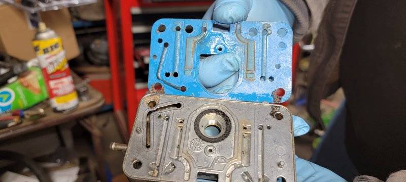

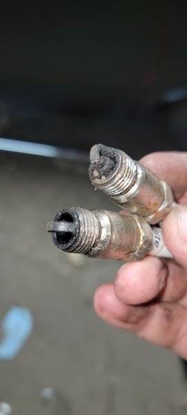

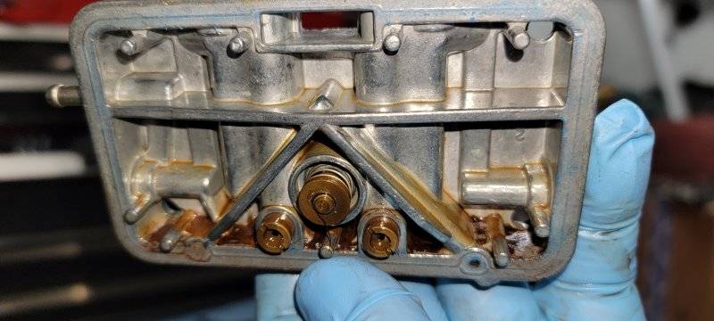

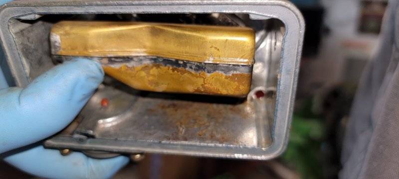

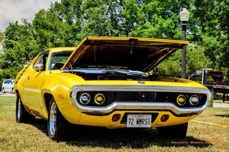

I just traded for this 1972 Plymouth Satellite. Some people advised against it and some were for it. I appreciate both sides of it but I ended up deciding I wanted it. It didn't run at first like the guy said it did. It would start and idle really rough. I ended up rebuilding carburetor, drained 14 gallons of bad gas, and swapped in new spark plugs. I got the timing set to 12 degrees at idle with a final of 34. Idle is at 750 which seems decent. Still more work to do but over all good bones. Also had to swap wheels out for pro stars, not a fan of the low profiles.
