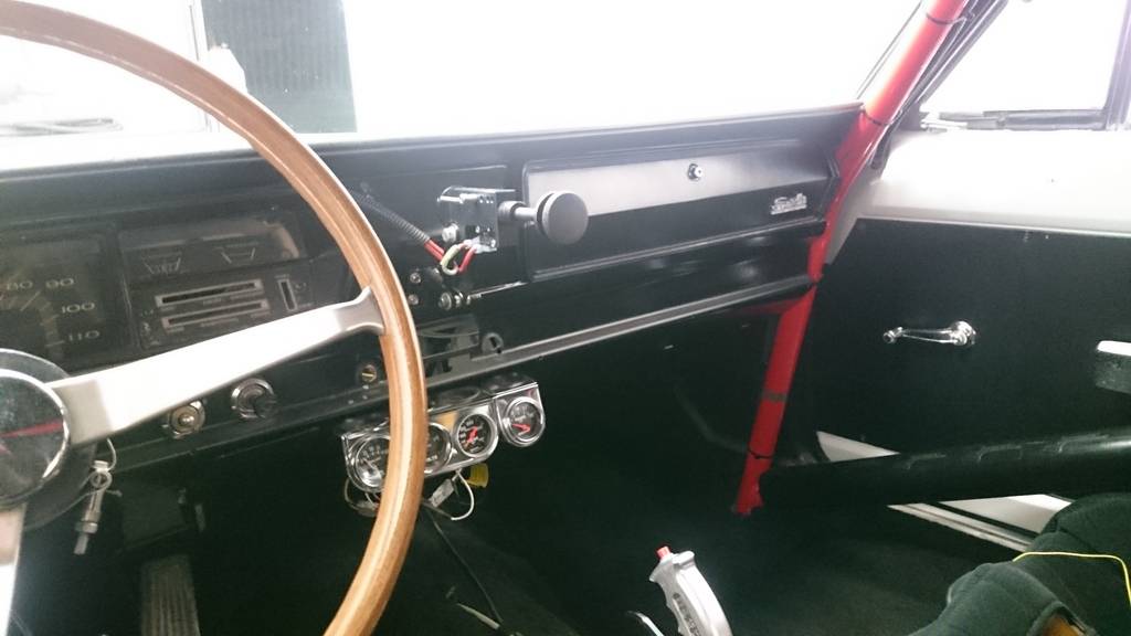

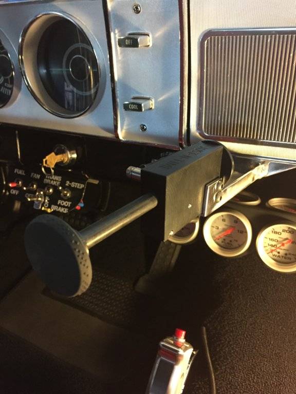

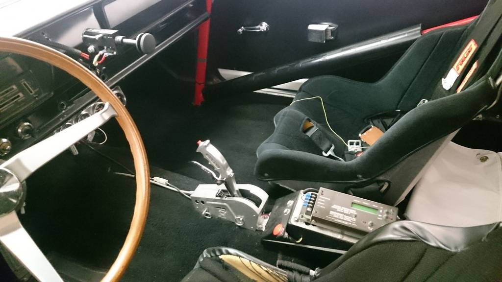

RacerAL is your trans brake on the dash ??
Noticed that too, I’ve seen quite a few guys lately running the brake on the dash
I have mine up on the dash as well. I seen one that was mounted vertically by the shifter. The fellow moved it after he launched once and his elbow grazed the button after launching. The car came down faster than it went up.
I’ll keep that in mind! Hoping to get my hands on a cope CRT-8 trans brake 727 soon
Yes my button is mounted on the dash. I fabbed up a bracket and mounted it to the dash. But actually I have two different buttons that can be used it just depends on what type of racing I'm doing. If I'm going off the bottom bulb like in the video I use the button on the dash. If I'm using the delay box I use a button that is mounted beside the delay box.
