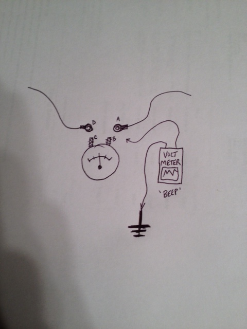

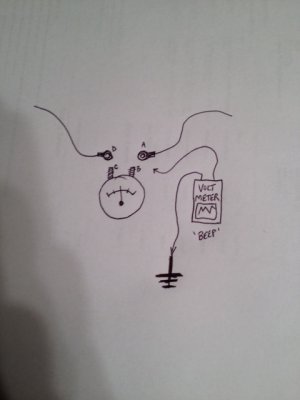

I drew a picture to help me explain what I found...
I like to put my handheld volt meter to 'beep' to check for grounding all the time. So... I put the black lead to a bolt on the dash. Then the red lead to "A" NO BEEP. "B" it beeps. "C" it beeps. "D" it beeps.
When I put the dash back in before the lightning show - I hooked A to B and C to D. Then the sparks flew... So I figured it was the ammeter... so I put A and D on the B post and still had the same issue. I don't think the ammeter posts are supposed to be grounded out like they are...
If I connect A to D will that solve my problem??
I was kinda thinking the D wire should not go to ground either... I read about bypassing the bulkhead and just running my alternator hot wire to my starter relay... which I believe that is what the A wire is correct? where does the D wire go to?
None of those connections are allowed to go to ground. There should be a fiber washer under the posts to prevent that.
You can connect A to D, but if you're going to do that you may as well do it under the hood and get rid of the wires going into the firewall to the dash. Some people install a volt meter instead.

Your ammeter should not be grounded on either post. You can connect the two wires together (A and D) to test, use a small clamp or bolt them together, as long as they don't ground out. Make sure A or D are not getting grounded from alternator to gauge to battery.

In your tests, do you have wires A and D disconnected from ammeter posts B & C. If so, then yes, the ammeter is shorted to ground somehow. If you left D connected to C, then B, C, and D will all be essentially connected together; the ammeter's internal resistance is only a fraction of an ohm.

Can't answer you on where wire D goes to without more info like wire color...you need a schematic. Go here: http://www.mymopar.com/index.php?pid=27
The D wire could have fairly low resistance if several circuits (like dome lights) were turned on when you did the test. Using the ohmeter in 'beep' mode' is OK for seeing if there is a 'low' resistance but it cannot tell you if it is a short or just a low but normal load resistance. You may need to use your meter at times in the lowest ohms scale. (You need to first short your ohmeter's leads together and read their resistance alone, and then subtract that from all other low ohmage readings.)
Thank you all for the help - I am fairly confident this is my ammeter shorting out (both terminals are grounding out, the one stud is really sloppy and so are the guts of the gauge). I printed out my wiring diagram got out some highlighters and found exactly what I was looking for. Im going to do the MAD upgrade.
