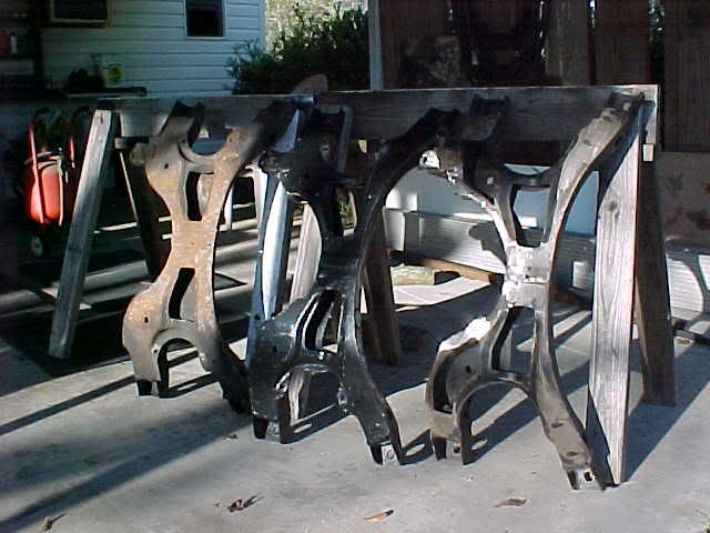

Shoot me a pm with your email and I'll send you a bunch of pictures I took of the reinforcing I did on my k-frame. I added 100+ spot welds to go with the 30 or so factory ones plus added in other reinforcing plates/welds/ etc. To do the spot/rosette welds I used a Rota Broach from Blair Ind to punch the holes. Easy to do but takes some time. Got a MIG unit at your disposal for the welding? You will also need to clean the k before any welding gets done. I had mine tanked twice, took a torch to the unit to burn off any residual and there was still crud lurking which showed up when welding.

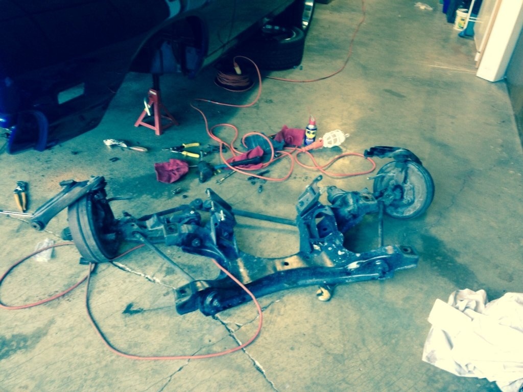

Got underneath her today ( just fun to say), K member does not look all that difficult to remove. Studying u tube videos on sequence of bolt removal. My car had no front sway bar so I will have to add that. Everything's media blasted to at least it's clean. Piece at a time.
Alright guys. I am getting ready to get that k member and other front suspension out for surgery. I plan on I bolting everything then lifting the front of the car with a strong tow strap and cherry picker so I can raise it up high enough to clear engine, trans bolted to k member. I'm searching k member removal right now. Can I ask for help with the process from beginning to end. Just don't to die by torsion bar. Lol. Thanks. Erik.

Get all the stuff you are re-using de slimed. Oven cleaner works well if you are a DIY type like me. Just keep away from other items as the mist travels, if its breezy, and does not get along with paint. Tough on skin too if you don't glove up.
Pics suck but you can see the ones that have been trimmed and solid welded. You have to trim and weld in sections to keep warpage at a minimum. You can weld without trimming it but imo, you end up with a better product if you do trim off the spot weld flange...and it does remove some weight.
I appreciate the info and pics. Will start prepping the K for welding over the next little bit. Gonna buy the ff k member reinforcement kit.
