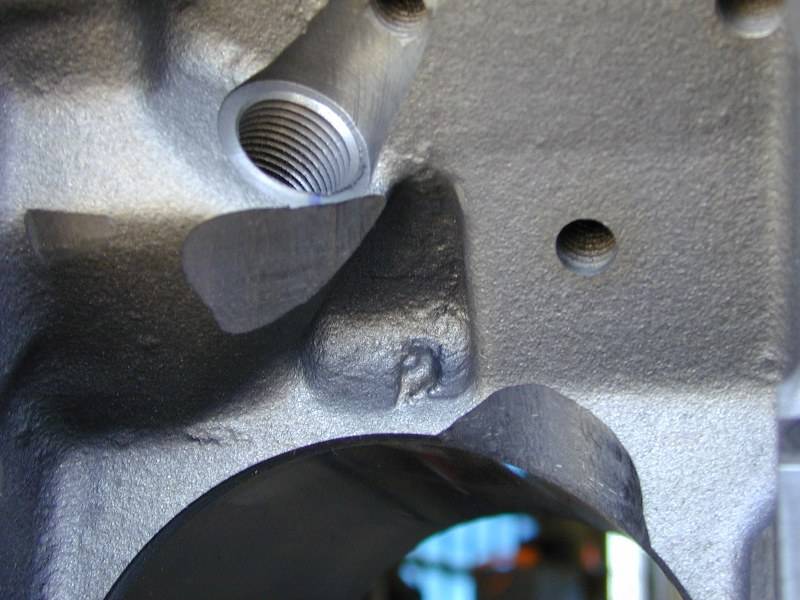

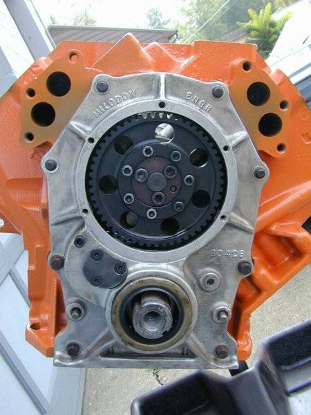

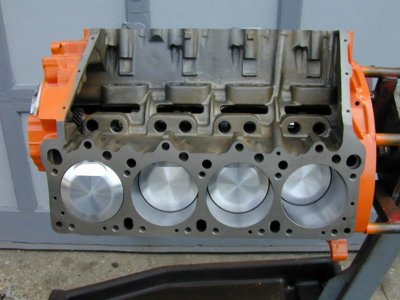

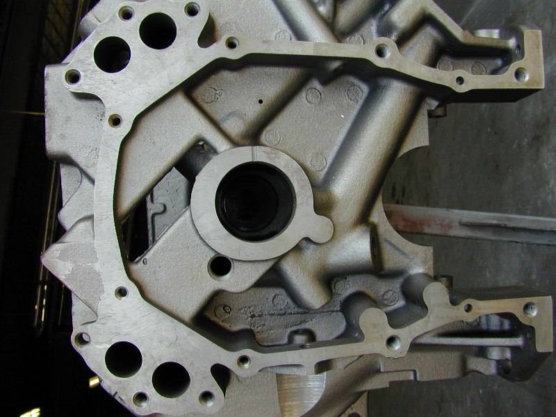

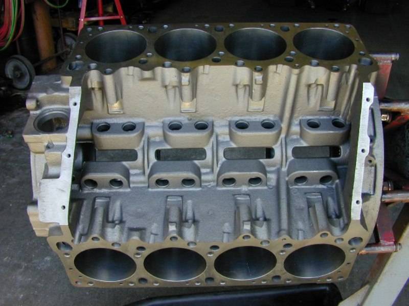

How much do the Bullydog bare blocks sell for? I thank my lucky stars I purchased a siamesed block over 20 years ago from Vignogna Peformance in the $2400 range.
Block2.jpg Block3.jpg Block4.jpg Block5.jpg Block6.jpg ShortBlock GearDrive1.jpg ShortBlock Piston1.jpg ShortBlock Rod4.jpg ShortBlock1.jpg ShortBlock2.jpg
@HEMI-ITIS , that $2400 inflation adjusts to around $3700 today. Can anybody find a good iron block for that today?
Funny thing, you could probably still get $2400 for that block, and you have had the use of it for twenty years!
Bet I could get twice that,but like my pushbuttons that block better outlive me!

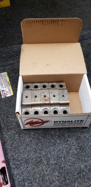

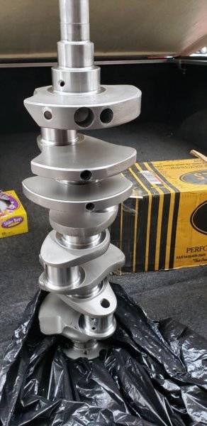

Picked up some goodies today.
Probably too old school. I have no idea if it's still being done.
Many, many years ago, trying to keep up with the digs, heard about many of the fuel guys doing this.
New cranks, there was a crank grinding shop in Grand Prairie, Tx (close by from me). Shop would take a new, or good used, steel crank, under-grind each journal, and heat spray hardened chrome on them. Build them up over-size, then grind them back to standard. Story was, those cranks would hold up, much longer.
