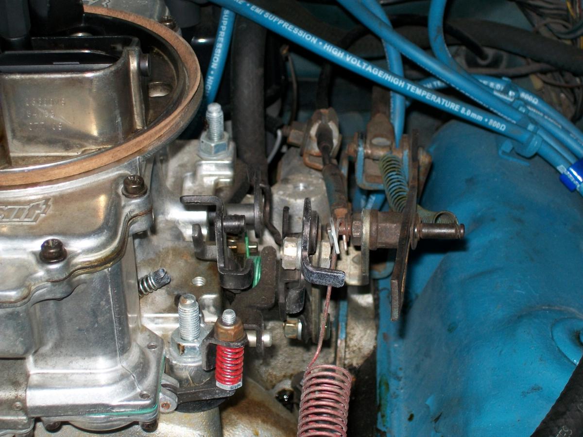

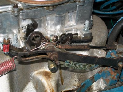

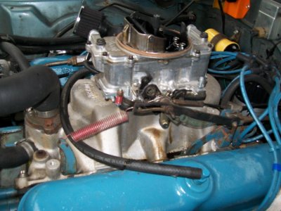

Here are a couple pics of my setup not sure if this is what your looking for. Hopefully it helps.

Anything you do to move the throttle stud from the original location will throw off the throttle pressure operation. You can remedy it a number of ways so time to get creative!
Hey 250, if your set up is like David's my instruction is way off. I suggest starting a new thread titled 67 kickdown linkage, maybe you'll get more help.

I dropped a new dizzy in it a few weeks ago. However the tape is a great idea I really need to check the advance and adjust it if needed. I also picked up an MSD coil waiting on the resistor part to show up tomorrow and then I will install that. Still trying to find where I read that I should open up the plug gaps. Internet is great but sometimes it is just to big. BTW here is a picture of what has been done so far. I know :worthless_thread: So here are some.
Before
After
And a picture of the car just for the heck of it. I know it is a four door but this thing will be one nice cruiser when it is done for the family.
Hey, 4 doors and good gas mileage is the best for cruising. If you pulled up beside any new car and opened up the back door anyone would be getting in yours. Oh by the way, your before picture's kickdown linkage looks exactly like my 1970's.
