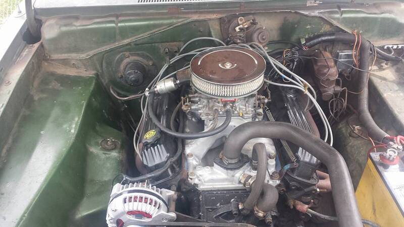

Worst case if you just want to keep the LA look you can get LA 318 heads and put them on the Magnum bottom end. Upside to 318 heads on a magnum block would be you could use your original intake. But that's only if you want the old school look. Also wouldn't it be cool to have a serpentine setup from a modern engine? I think the front accessories from the LA will bolt up to the Magnum block too. I'm just not too sure.
Here is a picture of a Magnum engine with a 4bbl intake in a 67 Dart. If you could find some Mopar performance Magnum valve covers it would look even better.
