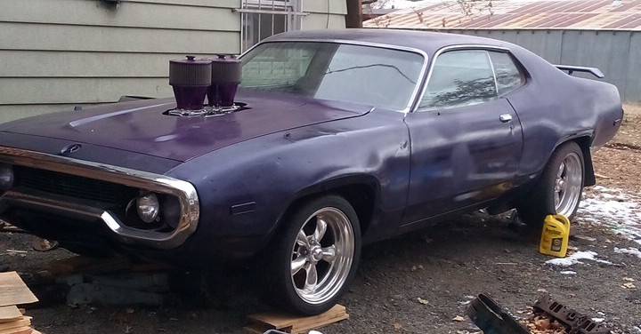

title says it all,yup the nutjob again, sorry guys...she finally runs, wanted to posta vid,not smart enough...she eats the drivers side motor mount when I blip the throttle, been through 2 already chaining it down this weekend..SIDE NOTE, TTI headers are a god send thanks for the heads up fellas, she shakes so bad, if I was woman with a tennis ball, I WOULD NEVER STOP CUMMING,,,i MEAN GRINNING...so yeah I need a tranny,,this stock one will grenade if I stomp on it. any ideas?

I'm already looking at 1100 bucks for a driveline,and been seeing 3500 bucks for trannies, I just need a built core, have cheeta valvebody will travel...LOL

after a littl mental acrobatics,I have come to realize the cummins 618 is the same as a 727, but with overdrive, sooo, I can toss the stronger goodies of the 618 into my 727 case and vvvwalaa, strong as all get out 727, some of the 1993 and up trannies have torrington roller bearings also, that a 800 dollar upgrade..I might be able to build me a tranny from all the parts in my backyard
