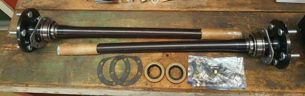

I am replacing my tapered axles but have a few probably simple questions.
1. I am reading at this point i can use my dent puller and yank theses out. Yes?
2. My new set up came with new studs for the rear end housing. Whats the best way to remove the old ones. Just beat them out or do i need heat?
3. when installing my new axles do i need to lube the outside of the green berring. Im assuming i should at least lube the o ring.
4. Anything i should look out for while doing this whole thing?
Thanks for the help

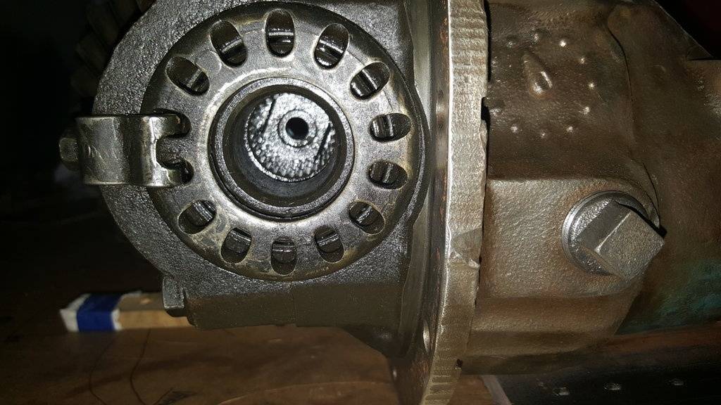

The thrust buttons are on the thrust block, one on each side. It's what the axles butt against to set the end play on a tapered roller bearing, originally on the axles. You're going to be useing the sealed bearings on your new axles so the thrust buttons are not needed. Cass told me he measures his axles with a tape measure so it would be a good idea to remove the buttons. They might interfere with the axle when installed.

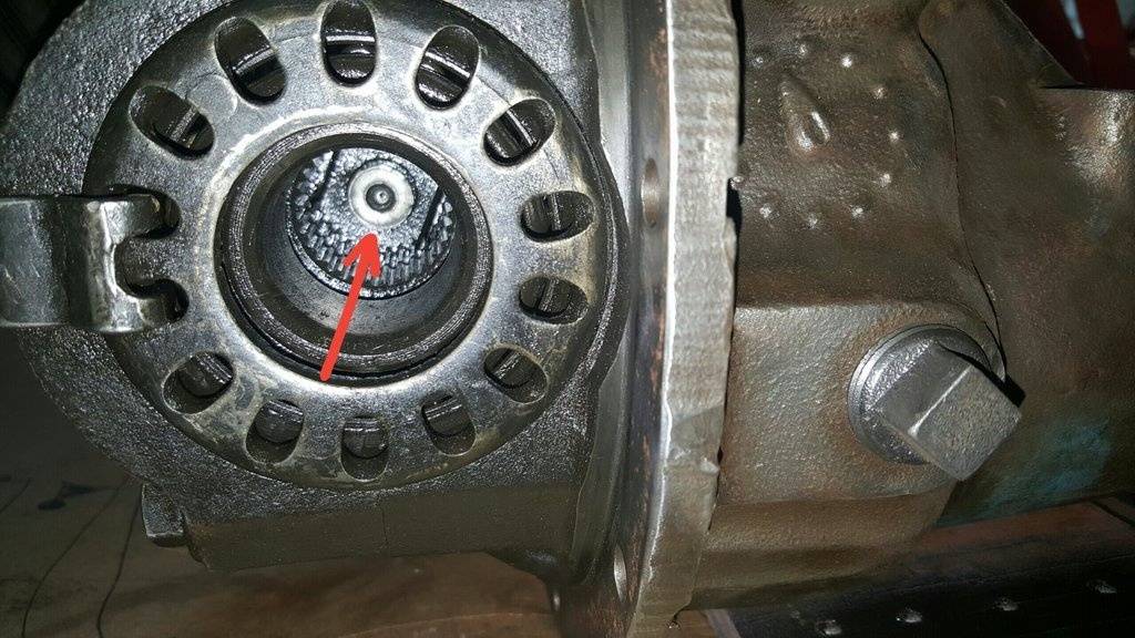

Here is the button on one side. There's another on the opposite side, held together with a small pin. To remove, it could be as easy as useing a long magnet to retrieve them. Worse case is you have to remove the center section (whole gear assembly) and drive the pin out in order to remove. Sometimes the pin is broken and they just fall out, or even stick to the end of the axle when pulled.
Picture with the button removed

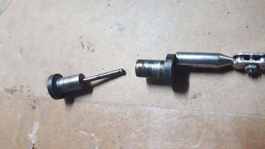

Buttons with pin. I had to drive this pin out.

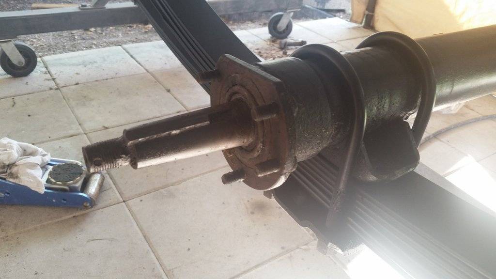

All done and went well although those 55 year old axles did not give up easy. I dont know what i would have done if i didnt have my slide hammer that i have not used since my auto body days in the 80s. Thanks for all the help guys.

They're advertised as "high strength". They're cut to the correct lenth for the 53 1/4" housing that these '62s use. They come with the newer "Green Bearings" installed. Yes, they are from Doctor Diff. Tell Cass what you have and want and he'll fix you up.

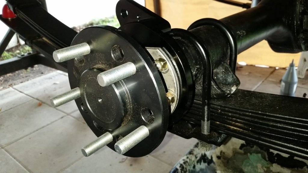

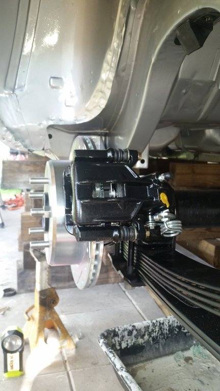

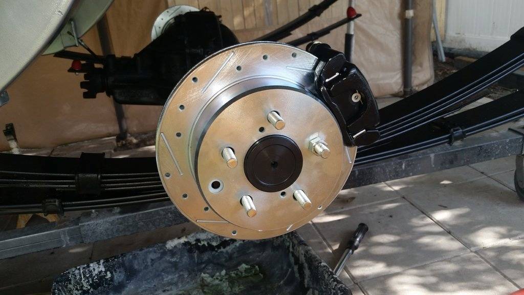

I did some measurements after I received mine and the brake drum will be at the same location as the factory, exactly what I was wanting. You will need the newer style backing plates, drums, shoes, hardware.
Dr Diff has the set up.This could not have been any easier once the axles were on with the caliper holders all i had to do was push the rotor on, place the caliper over
the rotor and tighten the two bolts. No shims or adjustments. Perfect fit
