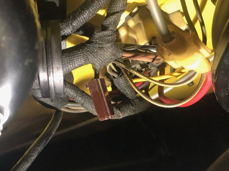

Need a little help with where this wire goes
Builderguy
Builderguy
10:57 PM
Sep 5, 2017
1,881
3,158
Alma, mi

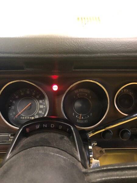

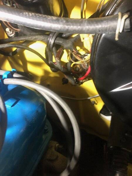

This wire needs a home but I don't know it's address. The brown connector with a black wire feeding it. I really don't want to rip the wrap apart to see where it goes. My wiring diagrams are not much good if I don't have the place it starts or ends. Trying to find it in the middle of the run is a little difficult. As the photos show it is just above the bulkhead connection. IDK may be for a condenser that isn't used on the electronic ignition. One or more of you may know where it goes just by looking at it (no wiring diagram needed). The car is a 73 RR 340 auto with electronic ignition. Little help would be great!!!! Thanks in advance.
Found a picture showing it. It was never connected to anything. Still would not mind knowing where it would have gone.

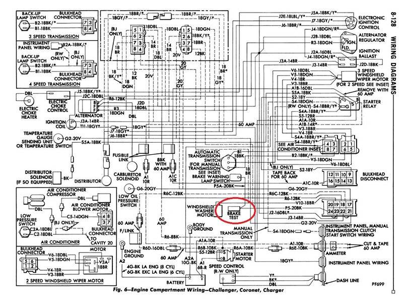

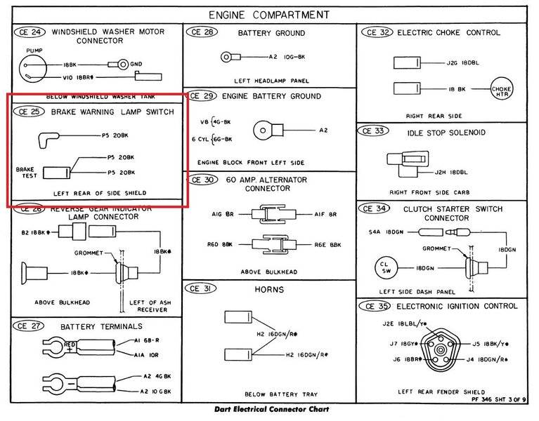

Labeled “Brake Test” in the '73 FSM diagrams, it’s the brake warning lamp circuit. Runs over the differential switch in the combination proportioning valve. Grounding it should get you a brake warning lamp with the key on.

You are correct Sir. "Brake Test" circuit. The light is on when grounded and key ON. When you know your ****, you know your ****! Thank you!

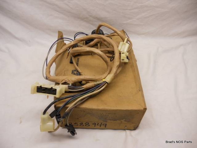

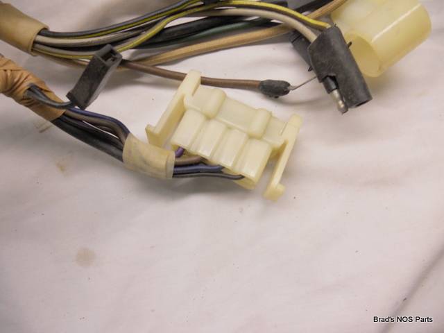

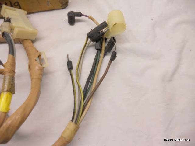

Found an E-bay auction that’s been around for while from Brad’s NOS. An NOS brown wrapped engine harness, in his description he can’t identify the application. Says it’s from a ’72 big block, the part number would seem support that until you try to locate it in the manual, the specific number is not there. But, notice it has a “Brake test” connector near the bulkhead connector. From the discussion in this thread, that would suggest ’73 and up. The ’72 California only alternator wiring disconnects is not present in that harness.

Could it be that there were two different supply chains? One for production/assembly plant parts and one for replacement parts. I have noticed that on some NOS parts, they were not the same as production/assembly plant parts. Looks like they were made by two different suppliers. They fit just fine, but have a slightly different appearance.

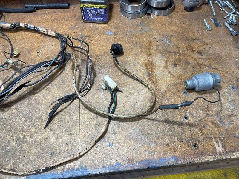

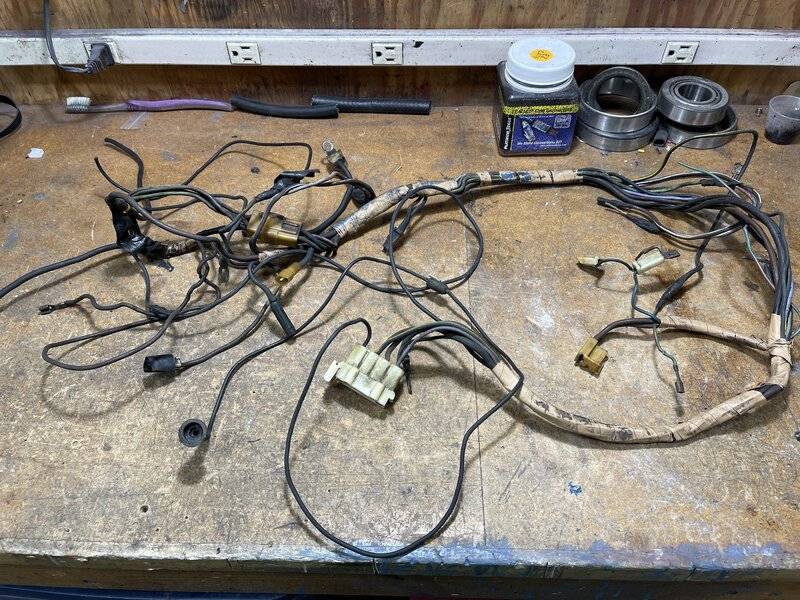

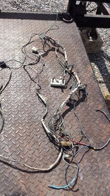

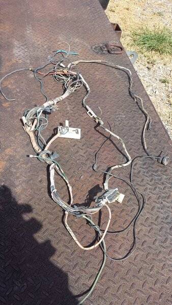

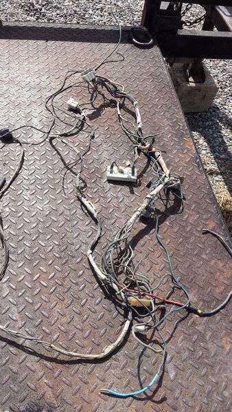

I thought I had seen that before. I dug through my scrap wire harness pile and found one. This may be the one from the 72 SSP 400.
