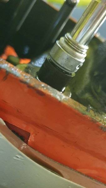

When i popped the intake off the pan there was some gas mixed with oil around inside port, also the intake valve seems to have a lot off grease around it from the topside off it, is there a way to see if the seal is bad? Mean if i just pressure test it from the plug hole it wouldnt let me know if the seal is bad, just lets me know that the valves seated correctly? I take the springs off in a couple a minutes with air holding the valves up. I mean what else could it be? If the pan didnt seal as it should then ive would have notice something from topside? Or can it still creap from the backside into the intake? Hmm
And the smoke im talking about its like a fat 2stroke mixured, just noticed when my kid was putting some laps in
If that inlet, guess #8 cylinder (with the greasy plug), looks more greasy then the rest you might be on to something.
Either valve stem seal or from the valley pan.
If you go to the extend of removing the valve springs anyway, just remove the seal and inspect the seal and seat on the valve guide for damage.
Then install a new seal, if there is nothing obviously wrong guess that is the best you could do.
If that does not solve it, i would focus on the valley pan.

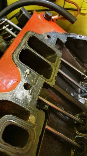

When you took of the I take, if there is any oilyness in the head 6 and 8 runners, its the valley pan leaking like Lew said. If they are not leaking, they will be bone dry.
It will not take much miss alignment in intake/head angles to cause a leak. The valley pan has no give. Sealants seem to be everyone's choice, but they never worked for me.

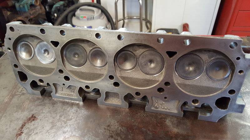

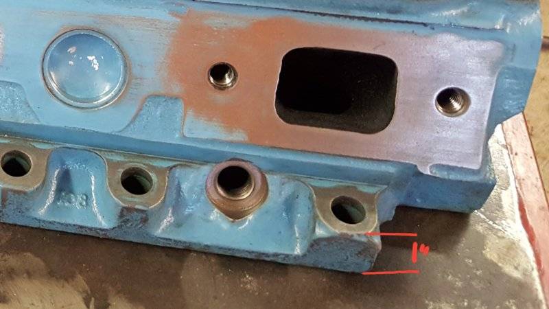

How much was milled off of those heads to make them 79cc? (You can measure the block on the lower side. Factory measurement is normally 1")
Here's a uncut 452
Lots of machining involved to make things fit when taking that much off a set of heads. The ends of the block where the valley pan seals can hold the manifold up if it wasn't machined.

Well, when i layed the manifold on first time the bolts and holes lined up, but i got a feeler gauge in between there but alot less then what the pan is, but i might need a real gasket for it to hold. But the RTV looks like it sealed on picture is 6 and 8 intake. But it looks like the valve seal has come off, gonna take spring off and look its kinda hard to see with dubbel springs on, but im tripple checking everything again so i appreicate all the ideas so i can recheck it all
The pan thickness has nothing to do with whether the gap is to big or not. It will leak badly with far less misalignment than the thickness of the gasket.
