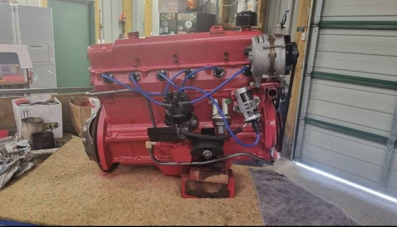

Hey guys,
My buddy Cliff is modding his Valiant /6 car - 225 and 3-on-da-tree manual trans.
This is not a search for an original part - hoping someone has experience, or has one kicking around - preferably new.
Looking for specifically a Carter 2BBL carb with an electric choke unit - or the facility to install an electric choke unit.
He already has a manual choke carb, and they don't convert that easy.
If anyone has one, or knows where I might find one, please let me know here. I have scoured eBag from here. :rolleyes:
Thanks,
Roger :thumbsup:
Gratuitous pictures for the picture hounds among us. :lol:
