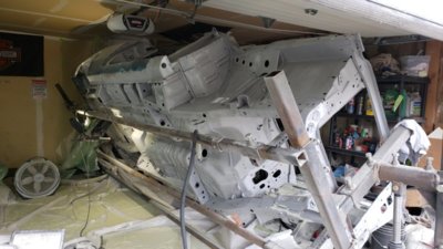

Inner fenders on the 65 is the best shot I have
Nice work there. Thanks for the pics.
