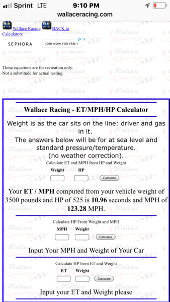

400/472, 4 speed, Dana 60 with 3:73’s running 275-60-15’s in a 69’ Dart GT. Using Holley Terminator EFI, headers, manual steering, sub frame connectors and I have ac. Just trying to get a ballpark figure of what kind of time it might run. I’m sure I’ll be spinning the street tires for a ways. Any guesstimates?
Street radials, weight around 3500, power is purely a guess 5-550. I’m just looking for guesstimates cause I/we won’t know till I can hit a track.
Wallace racing calculator has ya at 10.96 @ 123 calculated using 3500lb race weight and 525hp.
http://www.wallaceracing.com/et-hp-mph.php
Wow! That’s a lot better than what I thought it might be. Thanks for the help!
I’d bet mikes estimate is closer given you’ll be on street tires. Get some slicks for that bad boy.
I also estimated on 500....sorry 5.7...:)
Street tires and a 4 spd would take some time to get consistent, I think...BUT IT SOUNDS LIKE SO MUCH FUNNNN!!!!!!
I might get some Nitto’s and wider rims for track time, until then, it’s radials.
Thanks for looking into it for me guys, I appreciate it!

Now I might be wrong but, doesn't that Wallace racing calculator use Rear Wheel HP to estimate the ET not Flywheel HP?
Not to be a downer but he will be in for a big surprise after hearing all the numbers that are being used here and then runs a much slower number
It was a subjective question.... The calculators don't ask for gear, tire diameter, altitude or any other factors that can affect et/mph in other words a guess:)
