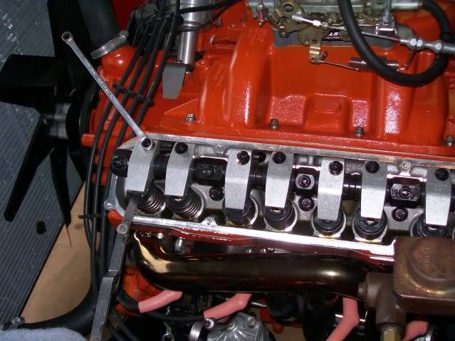

All I can tell you is I use these Hughes rocker arms , shafts and hold down hardware. They have been in my 440/493 for 2 years of cruisin and a few trips down the dragstip with zero problems. They are holding up good and stay in adjustment as I just adjusted the valves 2 weeks ago. I use a solid flat tappet cam. Ron

I agree about Hughes. You can see mine in the pic I posted earlier in this post but everyone of my 1.6 Hughes roller tip rockers hit dead center on the valve tip. They have worked flawless for over 3 years of driving and some drag racing each year. Ron
