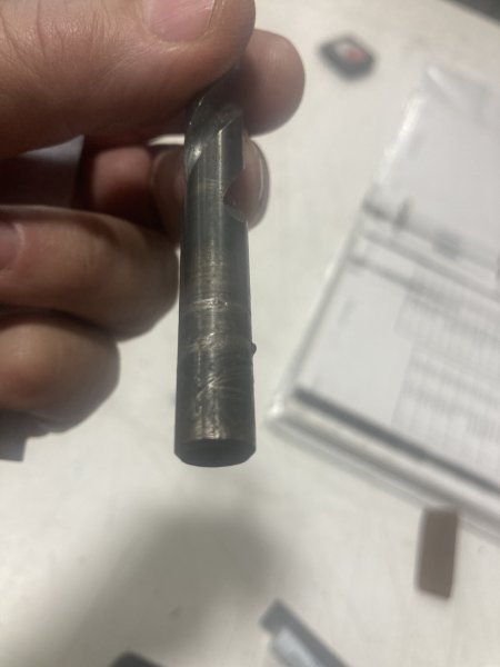

This is a HSS about 5/8. I was able to turn the shank down to use in a half inch chuck.
Like I said, I’m talking about high quality general purpose drills.
I don’t know about stuff you buy from Home Depot or the tool truck.
This drill has a burr from spinning in the Chuck a little. It will file right off.
If the shank was hard as the tip no way you would get that burr.
I would say that the shank is left soft to make it tougher, you don’t want it to snap off. Also it allows the chuck jaws to bite a little.
I’m not sure what process they use for. Heat treat, but my guess is they hold them buy the shank and quench the end.
But don’t take my word for it, grab a file and check it for yourself.

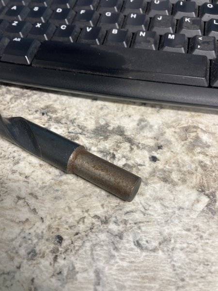

All the HSS drill bits I have seen have a shiny finish, not dull like in post #23. I am not sure what the material is in bits that have a dark colour, but they are a softer steel than HSS, will not drill tough materials like HSS will & they become blunt more quickly. The dark colour I presume is some sort of heat/hardening treatment. These drills are cheaper than HSS...for a reason.
A HSS drill is the same hardness throughout it's length. I have broken these drills, refaced the tip on the remaining section......& drilled holes with what is left. And I have done it many times....

The black oxide finish on the drill shown, is a form of lube to keep a drill from sticking or welding, at the cutting point. A large quantity of drills get that coating, it works well on tool steels. I have HSS black oxided drills and titanium nitrided(gold)drills and uncoated drills as well as carbide, with different coatings. They all have their place. This was what I done for a living, for 30 plus years. Now doing the same thing with sand and water.
