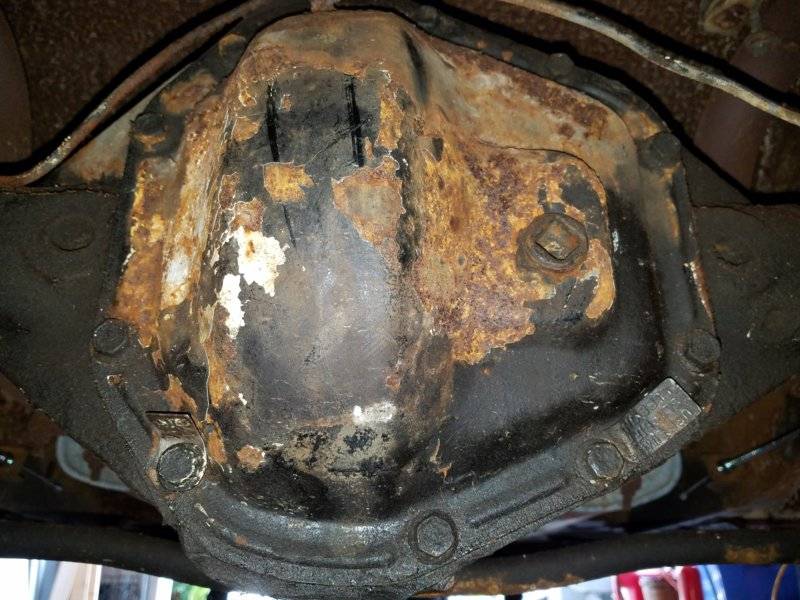

The 3.54 is a dead giveaway that you have a Dana. Post a pick and we will be able to confirm/deny.
It's a little dirty. Been sitting for 24yrs.
What is even nicer....that cover has never been taken off.....Document what you uncover and careful cleaning.....
Does the diff tag with 3.54 have any remnants of black paint on it?
Yes under all the dirt and oil there is black paint. Nothing wrong with the rear end I just needed to know what it was so I can order the correct brake line kit. Which brings me to another question . The moron tow truck driver that brought my car from VA to FL thought by cutting the e brake cable that it would free up a stuck wheel. My problem is where can I find any info on re-routing the new e brake cable.
