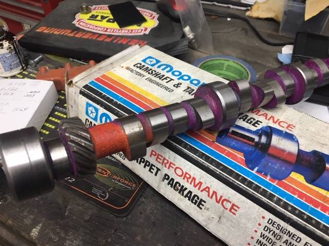

I have this Purple Cam for my 426 Hemi but the box is not correct for it. I have measured it several times but am not finding anything matching. This is supposed to be a hydraulic cam but I am not sure, I am wondering if anyone out there has any idea.
The nose to heel measurement is 1.525 (intake) / 1/522 (exhaust) and the base circle is 1.160 (I used a digital caliper), the rocker ratio is said to be 1.5 to 1.56; therefore I am coming up with .569 / .564
Iv'e read through many forums asking essentially the same question and obviously Mopar doesn't number their cams. Any help would be appreciated.

It's really hard to measure the way you are to come up with anything. And it's also really hard to tell, just by looking at it. However, I can see what you mean from the pic, it does look like a really flat ramp, bump right up to full lift, just like a mechanical cam would. You would expect to see a more gentle rounded ramp up on a hydraulic. Sounds like your best bet is find someone nearby with a dial indicator and a cam wheel, and then you'll know every detail in a hurry. Good luck, lefty71

Well I have ordered a degree wheel so at least I will have that. While I am waiting I decided to measure the cam with a digital dial indicator, I made a cam stand and got everything aligned and positioned, I did several intake and exhaust lobes to make sure of my readings. I am getting .364 on the intake and .359 on the exhaust; well Mopar seems to list there cams with rocker ratio factored in, so using 1.5, this then comes to .546 and .538 respectively. I have an old Mopar Performance catalog which has a list of cams for the 426, but nothing that matches or is really even close. I am thinking (optimistically) that this cam is P4349257 which is 524/507 lift hydraulic cam but am probably wrong, I arrived at this because there isn't more lift than this and the next cam is 572/557 mechanical but as I say I might be using some wishful thinking here. I will install the cam into the engine soon and measure the lift there I suppose.
So, I ordered a roller tip for my dial indicator and it arrived today, I remeasured the lobes and came up with some slightly different numbers which now have me thinking this is a mechanical cam (P4529344) which is .572/.557. I will mock it up in the engine and see what that says.
After some reading and research I am now very certain it is a P4529344, now to determine if this is a good cam for what I am doing.
