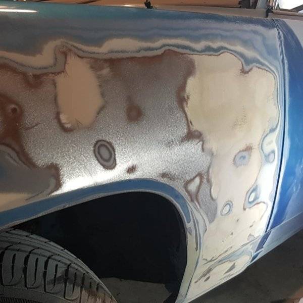

Gday b body peoples.

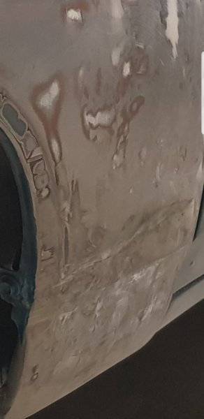

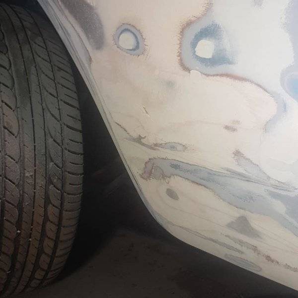

I noticed on my left fender the lower style line was kinda flat. So I thought there must have been a small dodgy repair previously done. What I found was multiple repairs over repairs.a few layers of paint and bog covering a few dents. I have attached pics of what has happened. Since this is my first attempt at body work I would like to know the best way to attack it. The main one is at the lower style line. It looks as if something has ran into the side. Is it better to cut it out or panel beat it into shape?
Might be hard to see in the first pic how its damaged.

Dig all the filler out and see what you've got.
Try to metal work it out, use filler to get it straight. If you can't get it to your liking before filler then weld in a patch.
Hard to tell in pics what you've got there.
Yeah I've flown back out to work now so hard to get more pics. I've drawn in 2 red lines on 1 pic. In between the lines the dent is pretty much a triangle shape that has been pushed in the length of the red lines.
Looks pretty gnarled. Not sure what tools you have access to but hammer and dollies will get you started but you may need a stud gun if it's over the fender brace.
Cut and replace maybe the only option if it's stretched out.
Agree with above post. Get the mud off it and see what is there , you should be able to tell how much it has been worked. Also how thin it is, if its been hammered & dollied a lot on that low piece watch for cracking. they upper dents look like they could come a lot closer with some work.
That bottom line just looking at the picture looks as if it could crack with to much working, hard to tell not seeing it in person.
Todays fillers have came along way, Typical in these old cars to find way more filler than was needed.
I hate people who think that they can do bodywork always putty and more putty get all out and rework yout metal a good body hammer and dolly im surprised someone didn't drill a ton of holes and use a slide hammer just be patient do you no of anyone who is a good meta man to help if you think it is too much for you :popcorn:

do not weld them on to much just use a light weld enough that you can lightly pull the pin and then just twist the pin off some people really weld them on and pull hard on the pin and tear a hole in the panel I like using this a lot more when pulling pins
hammer and dolly you should be good i will help you if you need just buy me a round trip ticket :thumbsup: have fun :rofl:
I have recently bought a 7pc hammer and dolly kit but not used it. I will look into the stud gun. Thanks
Yes it does seem someone has gone way overboard with the filler. I will have to wire brush the remaining filler out of the dents. Is it better to pull the fender off or leave it on?
Unfortunately I don't know anyone that does. You tube and you guys are where I learn from. But I do learn a lot from here and you guys
I would leave it on for support if you end up using a stud gun style puller, Hammer and dolly work would be more access if its off, but can be done for sure on the car with the wheel out of the way and front splash shield removed, headlamp ect.
A lot of the upper damage would come out fine with a long body pick/bar.
A heel dolly and a good body hammer will go a long way on that fender.
Some 36 grit on the DA sander will remove that filler pretty fast.

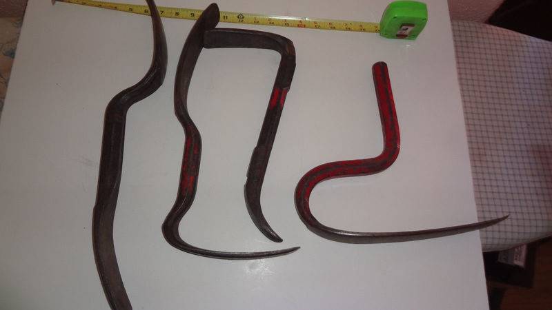

I will post up alot of photos of different hammers spoons and dollies
these are just some spoons
I will post up alot of photos of different hammers spoons and dollies View attachment 626843these are just some spoons
see i dont even know what all of these tools are used for. im pretty sure theres some kind of magic that goes along with these things.

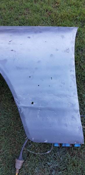

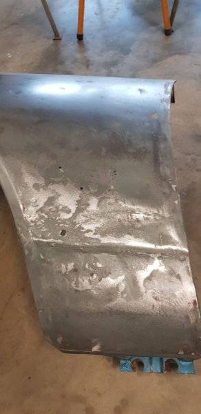

So I've managed to get most of the crease out except for the section over the fender brace. The bodyline has come back a little bit but it has a curve in it and it's not as sharp as it should be. Question is how do I straighten the curve and make it sharper?
