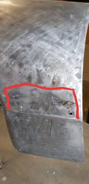

I'm not a body guy and still learning myself. I truly believe you will find switching back and forth working the hammer and dolly from both sides is best. You will get one area "fixed" and will then have to push another spot back in.So i done some block sanding and it has shown that from above the bodyline to where I have drawn in the red line it has a large low spot. I have managed to get most of the crease and other damage out but was stuck on this. To get this out would I hold a dolly behind the panel and tap the outside edge to bring it back up? I'
I've ordered a DVD from Peter Tomansini and one of his flippers. Posted this pic on a metal shaping forum and he got back to me. Hopefully they both turn up soon and I will have another attempt at it.I'm not a body guy and still learning myself. I truly believe you will find switching back and forth working the hammer and dolly from both sides is best. You will get one area "fixed" and will then have to push another spot back in.
