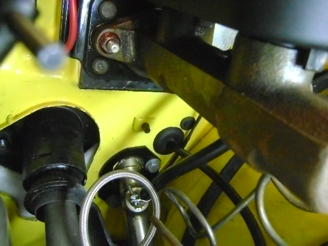

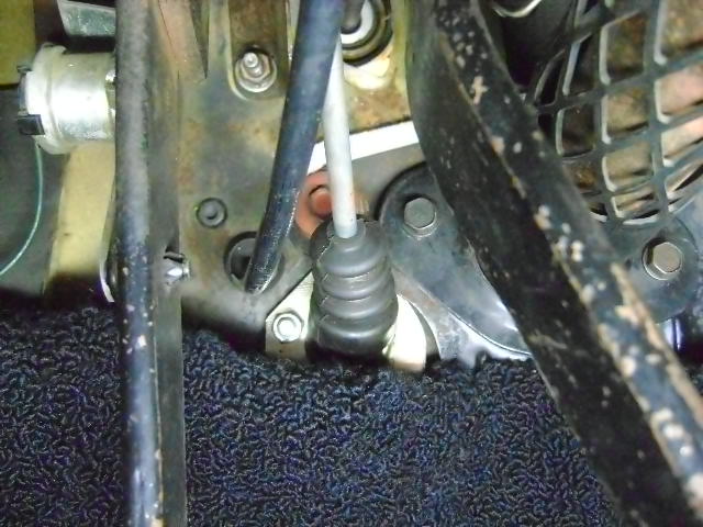

Cant find any where where the dang speedometer cable goes through to meet the trans. I was thinking right through the trans tunnel to avoid the heat of the headers but i cant find any holes where it would have routed in stock location. Anyone have a picture or know where it goes? Icant find a spot in the firewall either that it may have gone through. Thanks in advance

i just on my '69 RR.look straight down from the brake master cylinder.there should be an oblong rubber grommet and a round rubber grommet or hole right next to the fender well.my speedo cable goes thru the round one.hope that helps.
Photos below of my 70 Road Runner. I have a hydraulic clutch which may make it look different, but it goes in the hole where the factory clutch rod went. It is the cable in the center of the under dash photo and on the firewall pic it is the cable coming out of the black grommet right of the steering column and under the master cylinder. Hope this helps!
