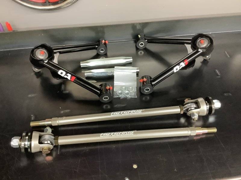

Only if you buy their tubular sub frame. I ended up buying the QA1 tubular upper control arms and tie rod sleeves. I didn’t like the idea of aluminum strut rods on a street car so I sprung for a set from Hotchkis.
