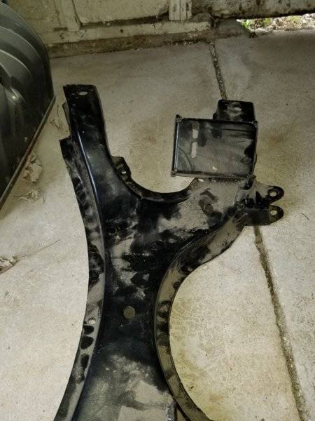

Need K member help!!

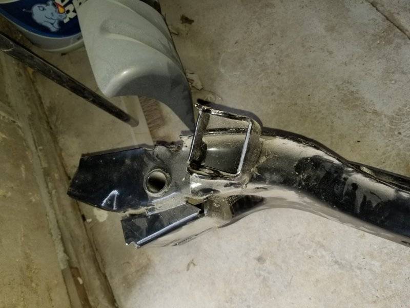

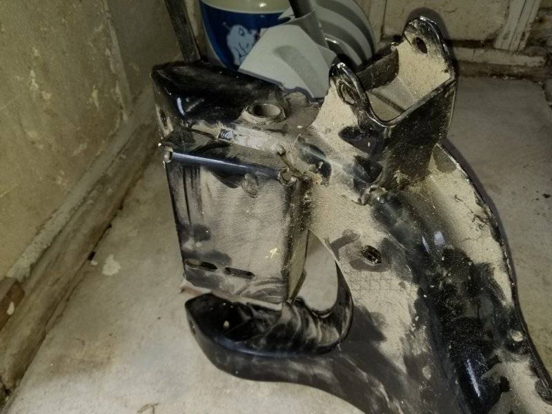

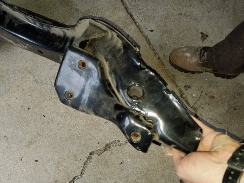

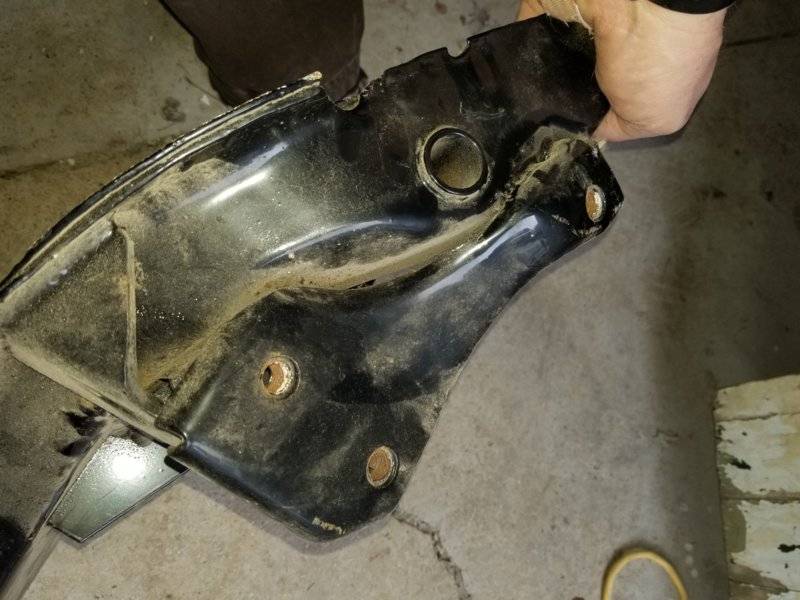

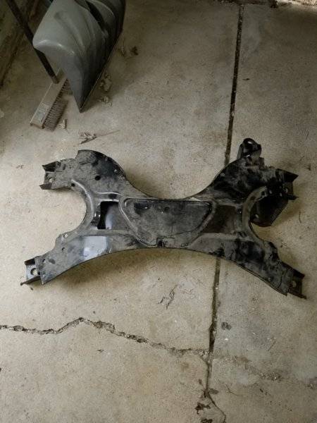

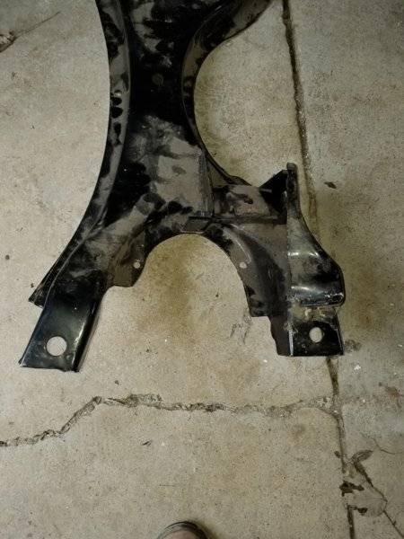

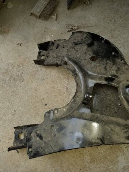

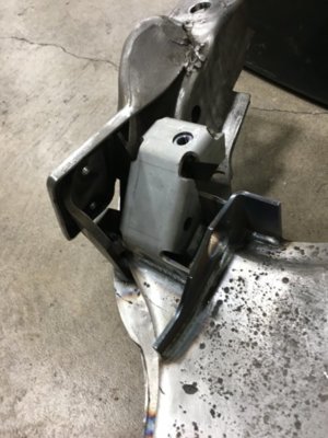

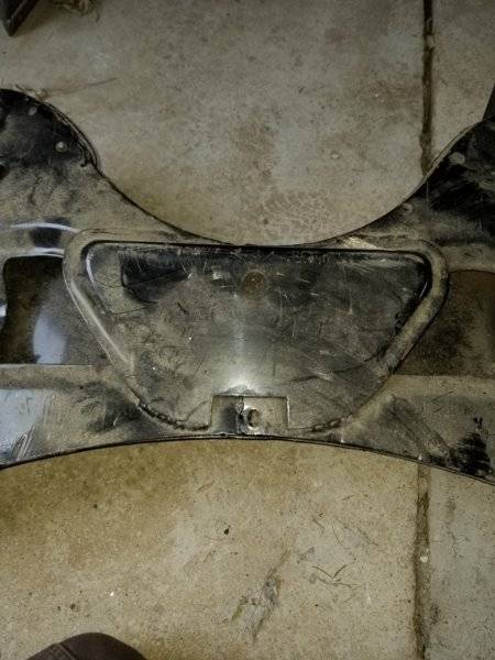

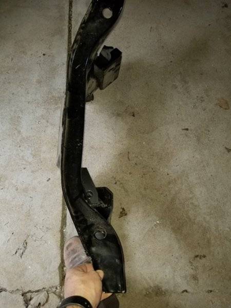

So here are some pics of the "E body" K member I got with my Hemi. I could not locate any numbers anywhere? Can you guys tell from the mounts or angles what it is? Any help would be appreciated. Thanks!
(Sorry for all the pics)

The passenger side is same as my 66. It looks like 70/71 K frame but don't know B or E. Driver side difficult no contrast. 70/71 driver's side eliminated bolt that came down from top. Looks like a hemi K member to me.

Looks like 70-71 hemi e-body. Most 70 b-body with skid plate had a coin on the front with a number. You will have to look at the welds to determine if it is original or one somebody converted. A long bolt or threaded rod in one of the steering box holes will tell you b or e for sure....pretty straight e, angle to the left as you sit in the car, b-body.
E body and B body have a different angle. My business has converted over 200 k members to Hemi k members. We have different welding fixtures for E & B. The motor mounts are also different. If you do decide to go with a correct one ours can be bought from Mega Parts
