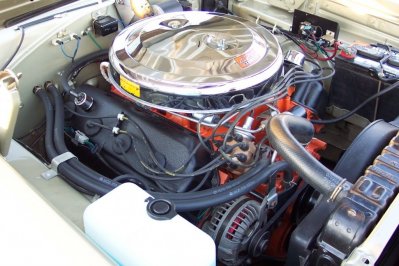

Wow, you hit the jackpot alright....sweet!! Too bad about the certicard though but it isn't a critical piece especially if you have the buildsheet or IBM card. Anyway, check out some of my pics; we have the exact same steering wheel. You said that you think that it might have been a dealer add on and not factory!?!?!
