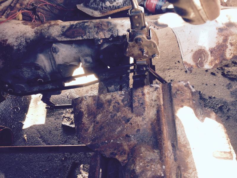

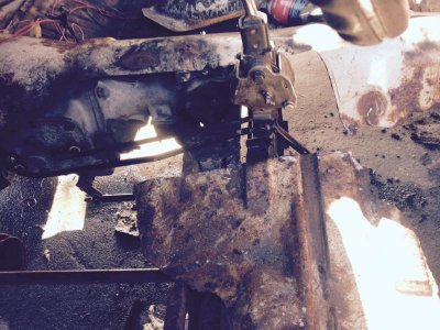

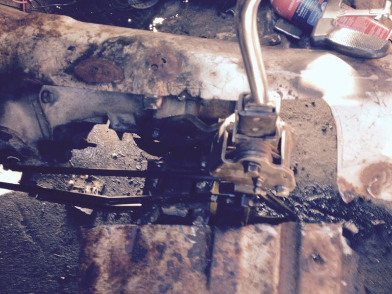

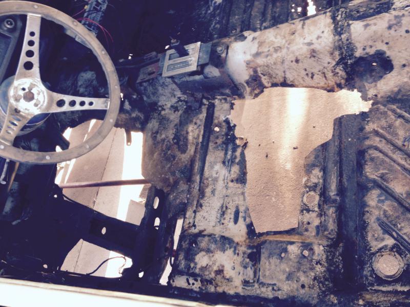

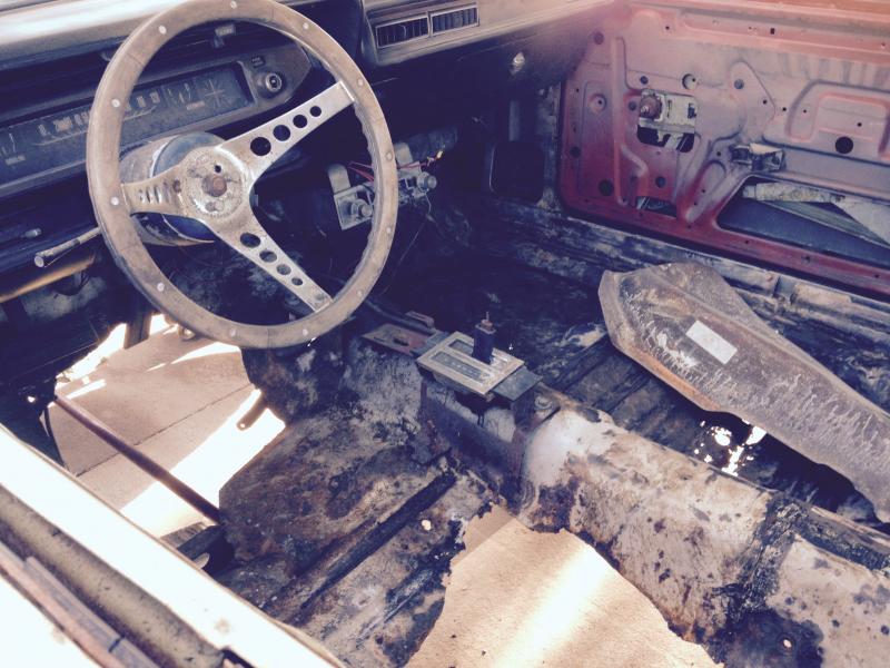

Well, Blackbird has cut his frame to make this work, the floor shift metal pan pretty much lines up, and he used mounting adapter plate to move his shifter back.
I have extra steel to re weld the frame back. It's very tight, access to cut metal comes at a premium. It looks butchered, in the middle of the progress, but I can see it turning out great.
