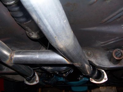

013.jpgmake your own H or purchase X.....I would have preferred the X, but I am an old timer...Flomaster exhaust mufflers..just my 2Cents
Do yourself a favor if you do the H-pipe and have that portion made with a split in the H with a clamp to tie it together. This will save you some access headaches and cuss words during future repairs.

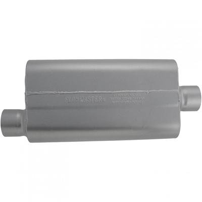

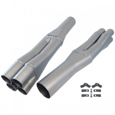

There's absolutely nothen' wrong with Flowmasters, especially the mandrel tubing 3" Flowmasters Muscle car system, but w/Delta Flow 50 series mufflers instead of the std. 40 series, they sound freaken' great especially with a H-Pipe & tail pipes all the way out the back... by the way I went 9.77 @ 135mph with the full system on, only picked up a little under 2 tenths un-capped after taking it off & most of that difference was because of the 100+lbs of weight {they aren't lightweight}, I also went 8.58 @ 156mph with a 300 N20 shot same combo, in my old 68 3520# RR... the Delta 50 series is allot better sounding than the 40's, well quitter & not as much drone that some people complain about.... Accurate Exhaust or TTI are a great fitting system too, also expensive... I always run an H-Pipe or an X-Pipe, it equalizes & actually helps to draw the lazy exhaust stuck in the pipes from the other side & the delta flow mufflers actually create a slight vacuum in the exhaust to draw out & get a little scavenging effect to the exhaust, add that with a set of Flowmaster's Scavenger Series 4-2-1 Collectors & you will have a great unbeatable combo... DynaMax supposedly makes a great free-flowing race muffler too.... good luck what ever you decide to run...
