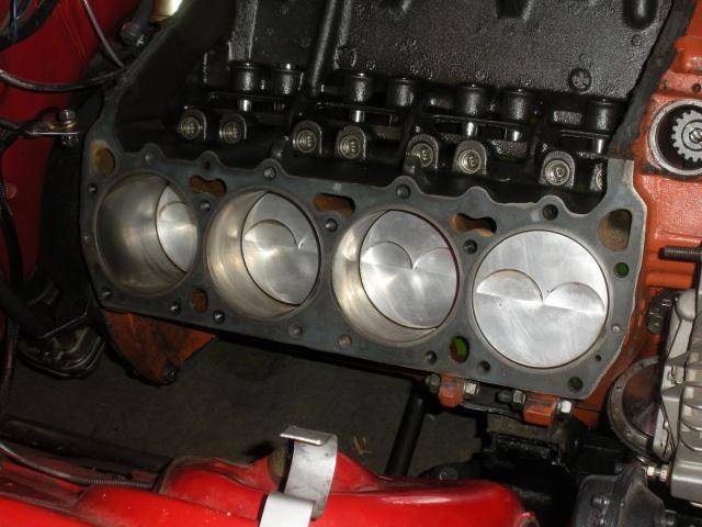

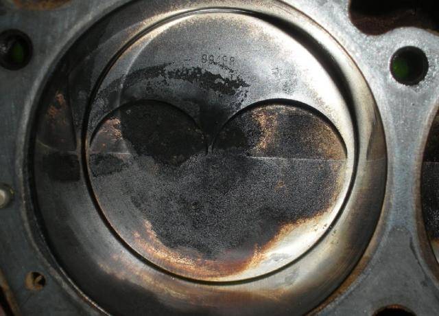

Also, I asked what I should expect to see as evidence of detonation when I pulled the heads. I was told to look for broken ring lands, sharp holes in the pistons as if they had been hit with an ice pick and chunks missing. Check out what my pistons looked like:
After cleaning off the carbon buildup:
Zero damage anywhere. No discoloration. The head gaskets showed no burns, no defects. I dealt with what sounded like detonation but there was zero evidence of it. The 110 leaded gas allowed me to run the timing back up to 35 degrees and the car ran like Jessie Owens with no knocking but with 91 octane, it was back to detonation sounds. This is a mystery that I never figured out. Why did it make knocking noises and show zero evidence? Was it because I always lifted off the throttle the moment I heard knocking? Was there no damage because I didn't push it enough to let the damage develop ?

Looks like you have a .080 mls gasket. (List shows .090 piston-to-head, with pistons .010 in the hole).
