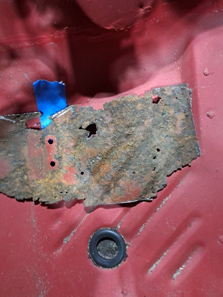

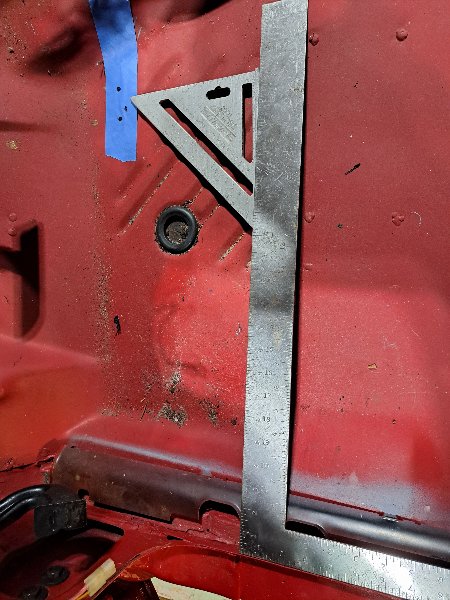

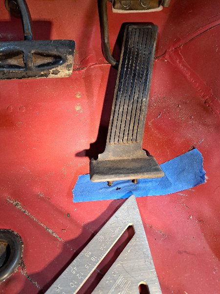

Well AMD does not drill holes for gas pedal or high/low beam switch these are the measurements I need. They also dont have e brake bracket or speedo cable bracket on bottom of pan so you need to save yours. If someone can measure for me I appreciate it. I want to use a square off of the rocker. I placed it at the joint next to the front of door. Thanks for any help. 1970 CHARGER @eldubb440
Oh I need the gas pedal and high beam switch hole locations as well. Thanks for asking.
my car and the pumpkin both have AMD pans...... I never even noticed holes or lack thereof (I never get that far)
I do have the original metal from the pumpkin in the scrap pile....... it's dark and raining, I'll see if I can find that piece tomorrow if you still need it

Dave, I have a 68 Coronet here at the house that has the carpet removed. You can come over if you want and measure for yourself so you get the correct spots. I don’t want to be the one that measured in the wrong spots. :poke:
