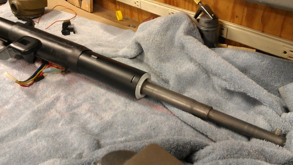

Dropped the 72 SSP steering column to R & R the dash. The FSM refers mechanics to the steering chapter after doing so, I believe to re-center the column with a special tool/gauge. Anyone done that before? Thank you.

Some floor shift columns without a reverse lockout do not have a lower bearing, just a seal and seal retainer. Yes, there was a factory service tool that held the shaft centered in the column tube while tightening the mounts. Without the tool, loosen the bolts on the firewall plate, adjust the three column mounting bolts and the height adjustment on the lower mounting bolt, center the shaft by eye as close as you can. Then tighten up the firewall plate.
Does anyone know if the column for a 72 bbody with small block 318 and 904 auto with slapstick has the lower bearing?
