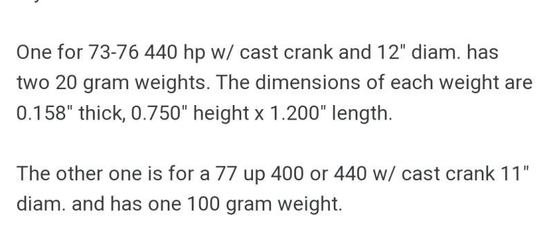

So you can convert to grams easy enough 1 ounce is 28.35 grams. Your balance weight will be lighter the farther it is from the centerline. I think a 440 cast crank convertor used two different weights over the years but they were the same balance: 77 and up used a heavier weight and closer to crank centerline; the other used the lighter weights but farther from crank centerline. I think 11 and 12 in the below quote are convertor diameter? The 12.9 in-oz is the overall balance and since the weight size is dependant how far it is from the crank centerline. Using the 12.9 in-oz should equate to 6.09" out for the 60 gram weights, 3.657" out for the later 100g weight.

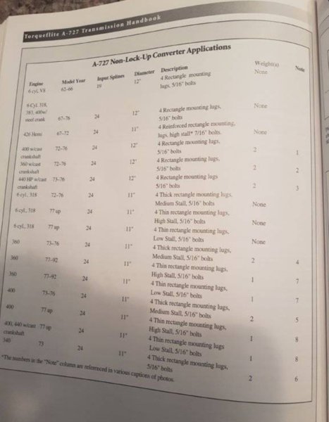

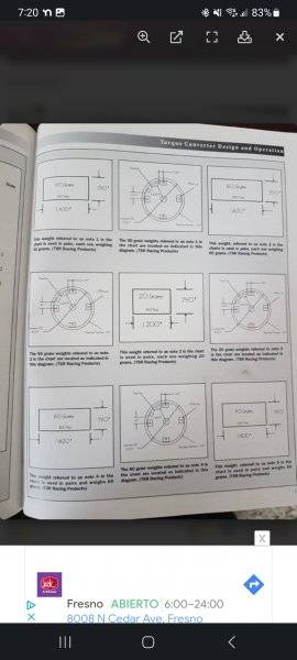

Below are weight sizes for the stock convertors:
So it looks like I need 2 of these 56 gram weights then!

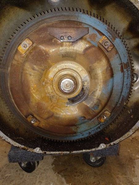

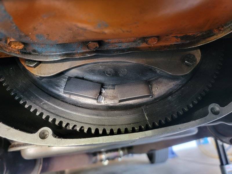

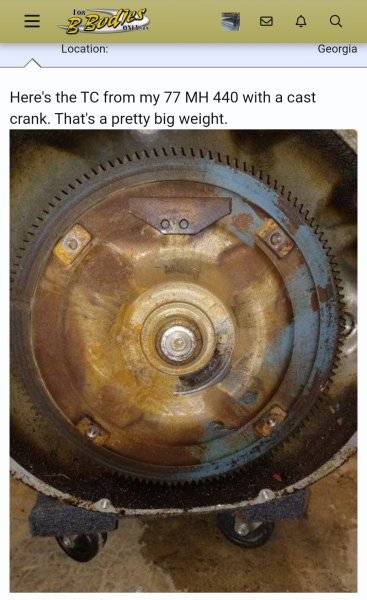

Here's the TC from my 77 MH 440 with a cast crank. That's a pretty big weight.

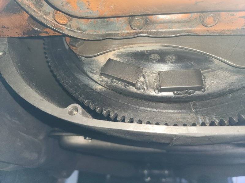

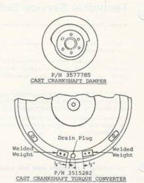

After much research, everyone's help here, and searching, I have determined that my converter needed 2 50oz weights. I found them on ebay and welded them on. NO MORE VIBRATIONS!!! for anyone with a 73 to 77 motor home cast crank 440 or 400, you need 2 50 oz weights in the locations below. Also you will need the weighted harmonic balancer that says for cast crank only, or in my case I got a Pro Products 80013 balancer and installed the largest weight.
My welds look like crap cause I had no room under the car but they are solid. You can actually see where there used to be a big 100oz weight that someone removed, that's how they did it in 78 and up, 1 big weight instead of 2 small weights.

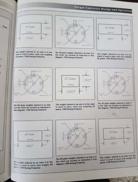

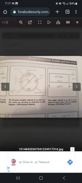

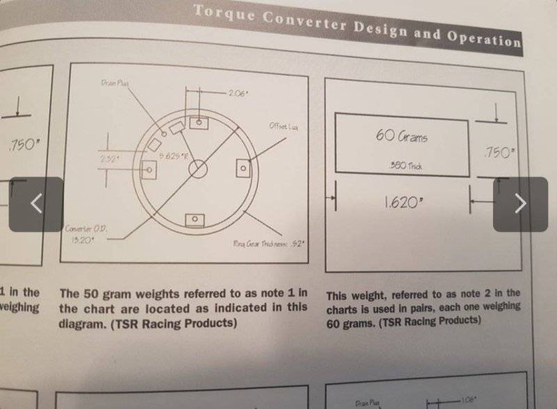

Nismobishi, where did you find these charts above? I can't quite read them, can you post better pics or can you email them to me? Thank you in advance, working on a front engine dragster running a 400 Mopar mated to a powerglide.​

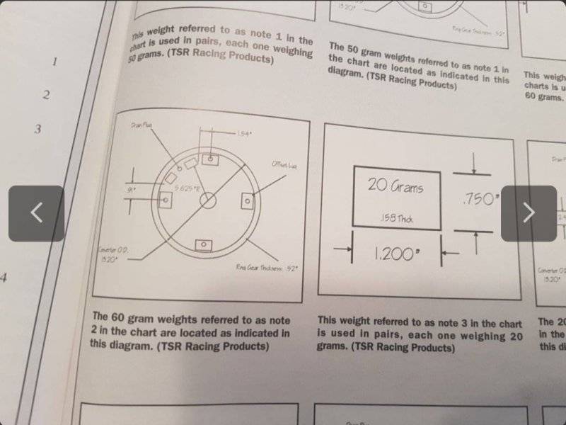

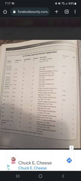

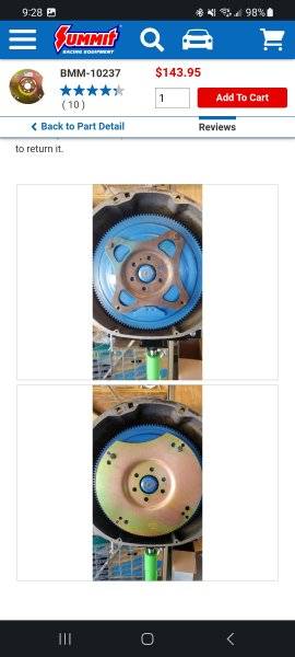

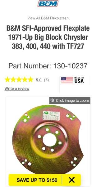

Above are the full size screenshots that you asked for. The chart is very helpful and you can make out the chart if you squint your eyes a little then you can match up those numbers to the location and weight size in the other diagrams. Unfortunately the copies I have on my phone are the same clarity. The pictures of the converters above, minus the last blue converter, is what I needed for my 74 cast crank motor home 440. They are 2 weights at 50 grams each. I found them on ebay after searching for torque converter weights. Alternatively you should be able to do 1 large triangle shaped weight like in the first picture but I don't know the details about that weight. Another alternative is the B&M counter balanced flex plate that has a notch taken out opposite of the weight location. That flex plate must be used with standard unweighted torque converters. You will still need a weighted harmonic balancer as well. You must have a counter weight at the front and at the back of the engine. I used the Pro Products 80013 harmonic balancer with the heaviest weight installed. I hope this helps!
I assume those pix RatRodAl put up are from the old Mopar chassis bible??
I'm assuming so. I can not remember where I snapped those screen shots from and I cant find them again. Luckily I'm a horder and save just about every picture that I find that has useful information in it lol!
By the way, These pictures are ones that I gathered from here and other forums. They are not mine. If anyone wants their picture removed just let me know. I know that they have been a great help for me and many others. Thank you!
