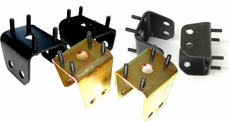

what front spring mounts are you using ??,
are they adjustable type with 2 locations ??,

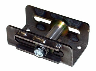

or possibly go with roller sliders on the rear of the S/S springs too, that lowers the car about an inch, helps springs a little

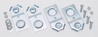

Calvert Racing have 1" & Mancini Racing make 3/4"- 1"- 1-1/2" & upto 3" in solid or extruded lowering blocks
where did you get the front mounts ?? what type/style/brand ??

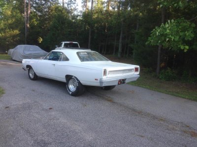

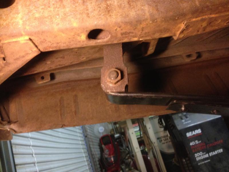

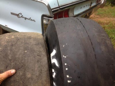

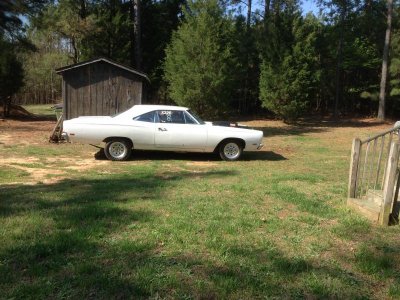

I got the MP front hangers. I originaly installed in the upper hold & car looked good. Ony went up a bit over an inch, but my pinion angle was 7 up. So I put them in the lower hole. Measured & went up a bit over two inches. Pinion angle now is at 1 up. Longer shocks (Comp eng. adj. )where within 1 inch from extended. Installed 29 inch slick from a 26 & car went up another inch. Now at 3 Measures same spot both sides & wrote measurment on car with yellow crayon. Gonna post all kinds of pic's here in just a minute. If I can get these last few little things worked out I will be ready to go racin...lol

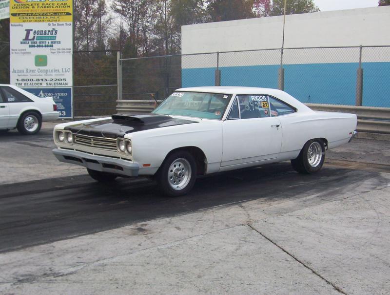

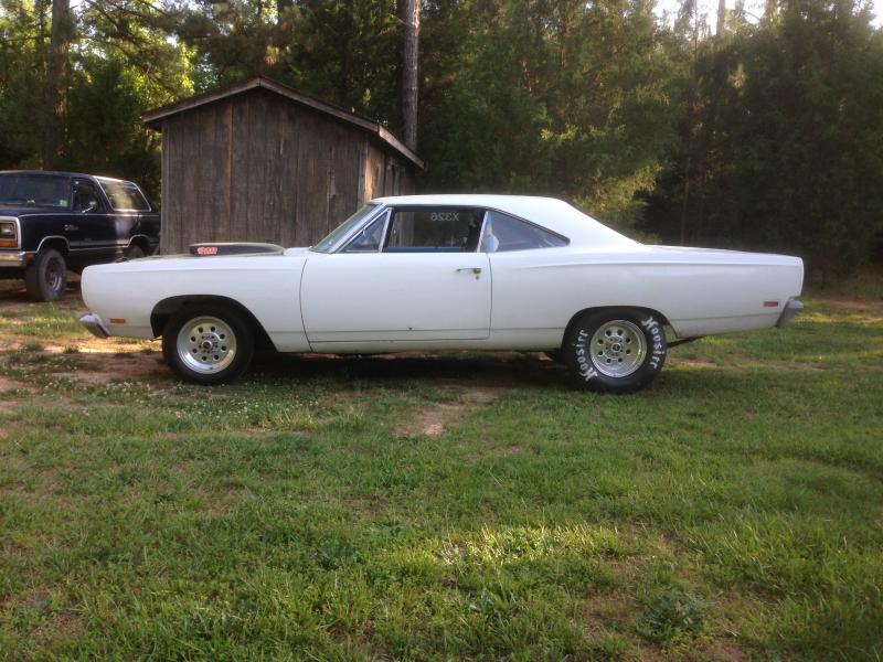

This was taken aout 6 years ago. Stock springs & 26X10 slicks as you can see car sat good with a nice rake. This is the way it was untill I installed the Mopar SS springs.

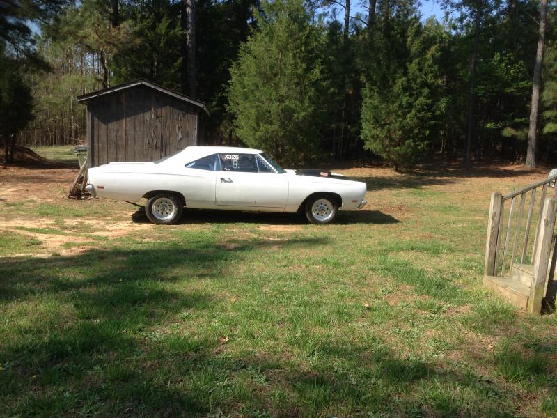

Taken last month Ss springs installed & MP hanger in lower hole. Comp eng adjustable shocks 1 inch longer still the 26X10 slicks. You can see car went way up in the rear. 2 inches. Also nothe the difference in the slick heght. 26 on left 29 on right

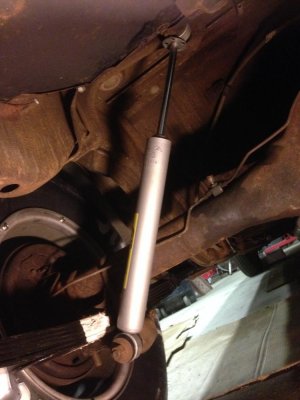

Pics taken about a week ago. Everything the same jst the 29 inch slicks installed. Also have a pic of the shock drivers side & the hanger drivers side. This is the way the car is today.

How heavy is your car and what spring rate did you put on it? I found a long time ago that a 3800 pound spring is way too heavy for a 3800 lb car and puts it way too high in the air and I'm betting it rides like a 1 ton truck now.....
Car with driver & full fuel is 3175 & I bought 3400 springs. I think thats the lightest they offer for a 69 B. body
I like the stance, after the changes, with the taller 29" tires/slicks...
I don't think it's a noses bleeder/too high or looks out of place...
I'm not the one that needs to be happy thou...
Do you have a rear/trunk mount battery ?? how big of a cell/how much fuel is in it ?? there's 10#'s a gallon in fuel, 50#'s for the batt., will you run any added ballast in the rear ??, all these will lower the rear slightly...
You could use a shorter shackle, but probably have to fabricate them yourself...
I'd go back to the upper front eye mounts & shim it accordingly too...
I would shim the pinion angle, to what you need soon as you get the ride height you want... or maybe cut off the spring perches & re-weld some back on at the correct angles, so it doesn't need as much shim or none at all... you could add some height to the spring perches too, make them taller to effective lower the ride height, so you don't have lowering blocks...
you could also add shock extensions to get the shocks back to where they should be, if you don't lower it or if you still need them...

Have not taken it out yet. With the rear shock fully extended like it is I dont see any point. Got to get that right or its just a wast of gas & time. Suspension cant work with the shock all the way out at static ride height.

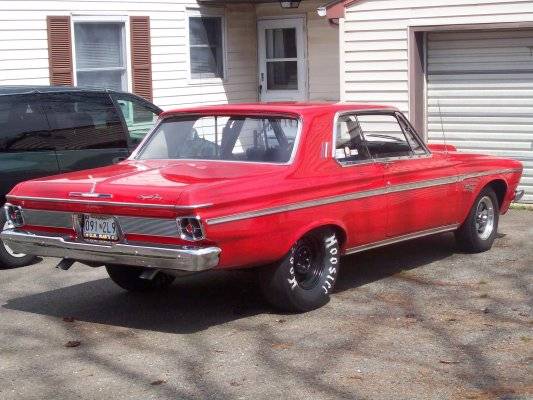

Wow 3175 is really light for your car ! It does not sit to bad with the taller slicks. Can you use the shock ext and try it like that ? On my 63 which weighs 3700 lbs I bought the 3400 lb SS springs from Mancini as they may be their brand as I never really asked. But this is how my car sits with them as it came out just right for me. I just use the SS springs with no pinion snubber and it seems to hook good on my 30 x 9 Hoosier radial slicks. Your car is a nice looking Roadrunner ! Ron
Thanks Ron. It looks better in pic's than in the steel. Time for a new paint job. Your car looks killer. I cant find the shock ext. Jegs, Summit, Mancin all say they have been discontinued. So I'm looking at either lowering blocks or fab my own extensions. Since my car is Drag only I was able to get a lot of weight out of it. I'm 235 myself so the car is quite lite. Are those stock type steel wheels on your car?
