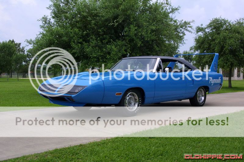

While it was a Superbird that was originally Vitamin C, mine was painted Petty Blue by the dealer before it ever sold.
This is a pic of my car 2 owners after me...
I sold it to Dave Kanofsky in 1997, he sold it to the Big Kahuna in Texas, and last I heard it was in NY, but it was for sale again for 275K
And the 145 MPH was driving down I 65 to the Mopar nats drafting with a couple friends in their birds, another 6 BBL and a Hemi...
