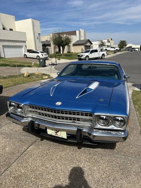

Got some pictures of this fine bird?

Thanks for the replies! Here’s my new to me roadrunner
