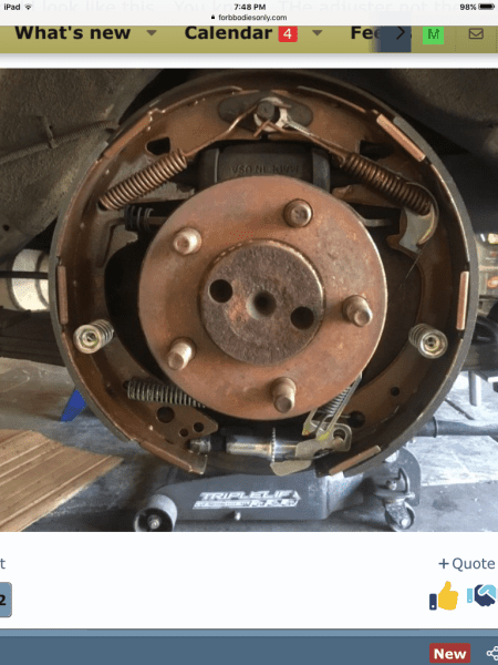

Here’s one I took couple summers ago on mine before replacement
Recently did my drum brakes for the 1st time ever. Take plenty of pictures before you start. little details like which spring gets hooked from the bottom of the stud while the other goes over the top will save you a lot of time. Don't sweat it, take your time and rely on the photos. Good Luck.
