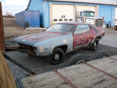

Got my Satellite 3 yrs ago, pulled from a swamp- No engine/tranny/wiring
The body still requires smoothing out but its all mostly metal as lower quarters/rocker/lower fender/holes in the floor have been roughed in.

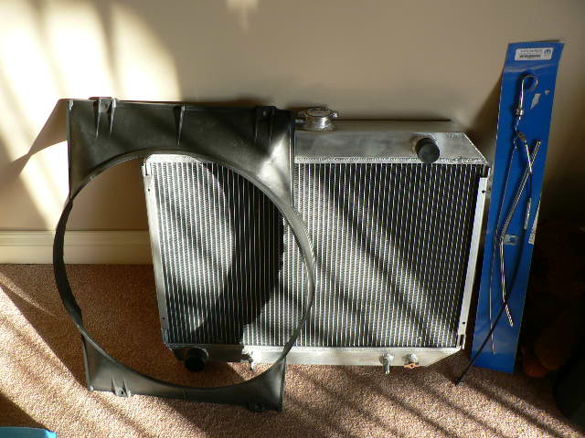

Got the rear end repirched cause of the 3 " difference from the earlier 8 3/4.

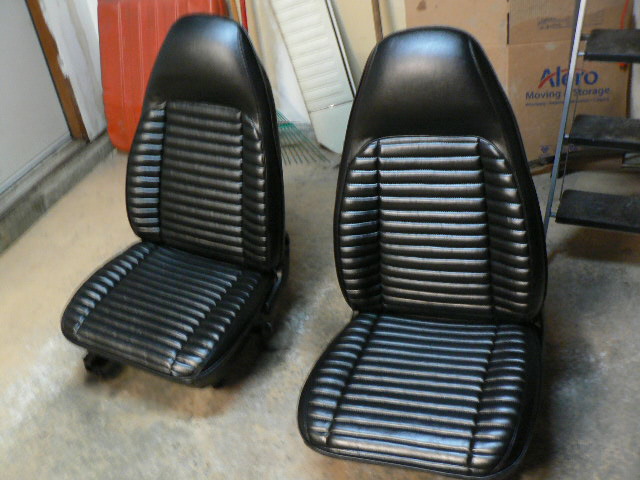

Added a leaf spring to make sure my car doesnt fall onits face.Died my seats black and they look perfect.New alum rad/shroud.

Seats look great 72...What brand of Vinyl dye did you use?

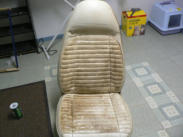

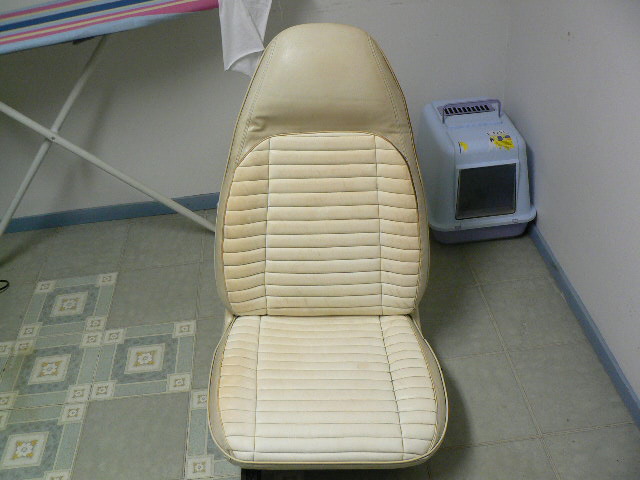

I started with really stained seats - used clorox(bleach powder cleaner and a green scrubie) Making sure its perfectly clean
-They actually didnt look too bad at that point but not the look im going for
I used Dupli-color high performance vynal spray coating 1 can gloss each and 1/2 can of flat to reproduce the semi gloss look
Ive tried scratching it up- its very durable coating and fits in my budget
I can allways spring for the 350 buck covers later
