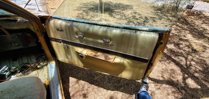

Hello! Here is a picture of the original door panel. I believe I have the chrome pieces for the straps, but I only have one of the original pull straps.

It looks like you changed to a black interior.

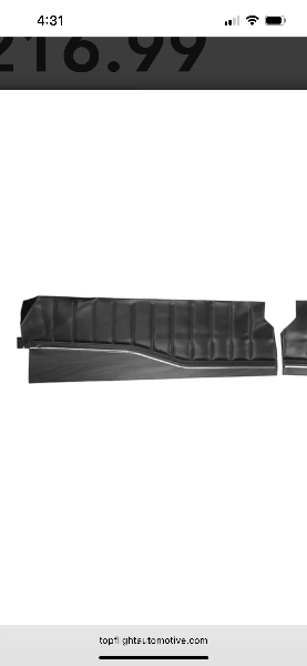

These are the panels I bought.
That looks like a low line (VIN WL) panel, so no provision for a pull that would have been on WP VIN (SE) cars or brougham interiors.
Unfortunately it was the only option for replacement. I couldn’t find replacement Brougham panels.
Might be a blessing as those pulls are prone to pulling out the mounting screws.
