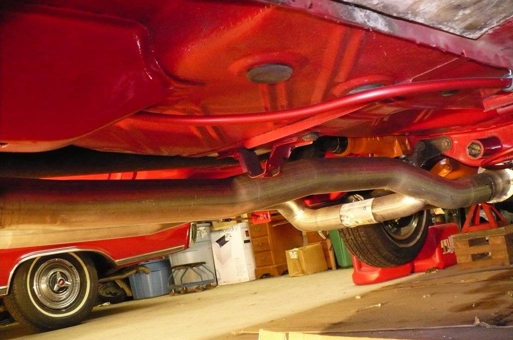

My 65 had the e brake bracket on rear frame rail like later years. I put a later set of brake cables on the rear. Made a bracket for the front e brake cable. Fabbed a rod to connect front to back cable. That e brake system on pre 66 sucks with headers. If you enlarge picture you can see bracket hanging just below and behind H pipe.

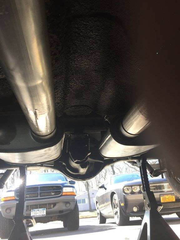

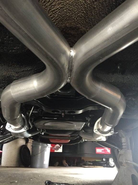

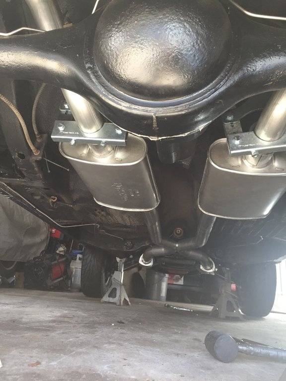

I installed my tti system in the wife's '67 Cuda. The exhaust pipe fitment was a pain. Then I realized that the adjustment s needed are actually simple. It will be EZ next time around.
The 45* pipes from the X (& probably the H pipe) the the headers reducers needed be sized, AKA cut to fit the width.
I cut the pipe side that goes from the reducer to the X as far down as possible. (Pipe cut as it goes into the "X".)
This narrowed the width and allowed it to be bolted to the reducer. A slight push and it was aligned.
The pipe to the muffler needed to be shortened. I hung the mufflers and tail pipes. Places a box under the muffler to prop it up as high as possible to mimic the installed height.
Then lifting the exhaust pipes (connected to the header)
I just used a sharpie to mark where I wanted the cut.
Took the pipes out, cut on circular saw, reinstall them and connect into the muffler.
Had I known this is the best and easiest way, it would have saved hours.
Next time I do this exhaust, it'll be 2 hours from start to coffee after clean up, feet up.
Ruff fit after cutting. A little WD-40 helps slide pipes in and out and around.
Minor adjustments made later. Over all, really a good system.
