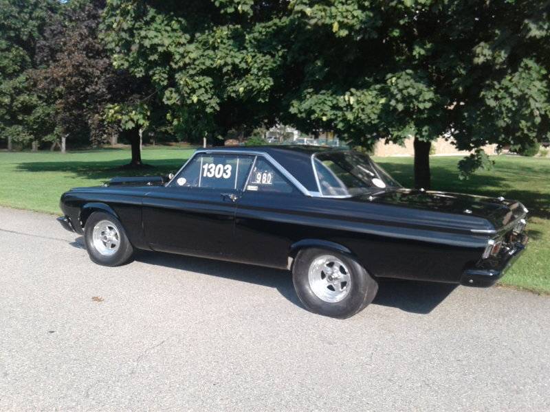

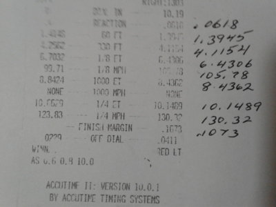

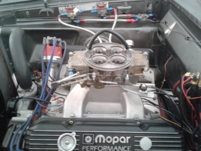

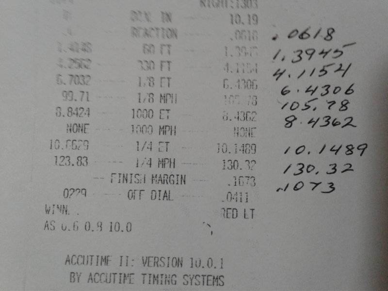

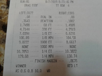

1st post 1964 Belvedere 400 stroke to 451 cu. Dana with 4.56 and Cal Traks I am thinking the 60 ft is slow. Took off regular gas shocks (worn out) and installed Viking doubles on the front. Any thoughts?

Welcome aboard from Ohio. What the heck is wrong with a 1.30? Sounds like working pretty good.
1.39 I trying for something around 1.30 to 1.35
Sounds like it is easily doable. Practice and a little tweaking here and there, you will be fine. Welcome aboard from Alabama.
I put new Mickeys 10.5 on it. Has 7 passes on them. Maybe they haven't come around yet. Hopefully I can get lower 60s with the new shocks
IMO I think that you're doing well. You could see some 1.38's but you're doing good as it is. What kind of HP are you making, car weight and are you on split mono leafs?
Nice Car! Your time slip looks correct for 60ft, 1/8, and 1/4 for that ET. Enjoy the car.
2800 lbs last year with 6 point roll bar. Added front half to make it a 12 point. Shipping weight was 150 lbs. Haven't weighed yet this year. Dyno sheets showed 610 hp. Yes to the split springs.

That's a pretty light car. Lots taken out of it.
The best I got for 60' on split mono's was a .138 60, not consistently.
Fiberglass doors,front end and trunk lid. Will be doing test and tune soon. Will see if the new shocks help any.

That 60ft is about right for that ET. The only way your going to get to 1.30 at that power to weight is a very steep gear and loose converter like a stock eliminator car. Takes power to get the 60ft that quick. The only way to add power is to multiply what you currently have through gear ratio and converter. That will likely put your combo rpm higher than you like in the traps.

Just slowly looking it over to see if I missed anything. So the 60 ft will be what it is and you're right about not wanting anymore trap rpm. Never been told to stop looking for more of anything. Had my 3300lb 35 Plymouth with a 400 running 10.60 to 10.80 with 1.43 -1.45 60s
Going with a lower gear set in your trans will help the 60' a little and not effect your trap RPMs, high gear remains 1 to 1. Sometimes when a guy is looking for more he can more than just a lower 60' In my experience, on the hunt to find more - split mono leafs and cal tracs are going to need to have dble acting shocks all the way around and the rears will need to be "good good" ones that will hold the rear diff from jumping out from under. Controlling the rear shock rebound becomes a chore, and the more you throw at it, the harder it gets to control. In my experience. Front shock rebound also becomes important too as you find more.
When I first looked at your time slip it looked pretty darned good to me given your HP.
