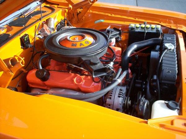

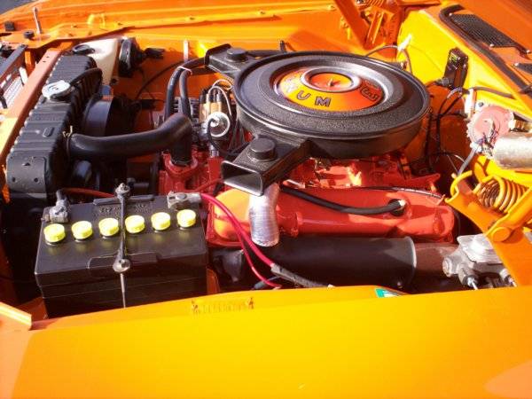

I'm looking for some input on my '70 Dodge. The engine is a '71 Factory 383 Warranty motor, basically 335hp, 4-spd, with a mild cam, and aftermarket rockers, running stock HP Exhaust Manifolds, nothing radical. A friend gave me an Edelbrock 7186 RPM Intake, along with a Holley 670 Street Avenger Carb, H80670. I was thinking of putting the set up on, and modifying a Mopar Oval Air Cleaner (6-Pac style), to let it breath easier. Any thoughts as to whether the 670 is a good size for this ? Currently being fed with a 5/16" fuel line, and the carb is a dual pumper, 3/8" feed. Any & all input appreciated, Thanks...

Sure looks nice the way it is. I'm still not sure what carb you have today? Holley 650 double pumper?

I really like bee's suggestion to stay with a Carter carb, just a bigger one since you won't have to modify that beautiful air cleaner. I don't believe that using one of the big oval air cleaners will help you much, if at all, unless you go all out & add the whole ramcharger setup.

Whoops! I saw what you got for free....sure, try the intake, but don't swap the carb since you'd have to modify/cut some air cleaner. Most Mopar bases I've seen are made for Carters.....though some 440's had small Holleys. Maybe you can find a base that fits & keep your lid so you can use the 670?
My 70 340 uses factory air cleaner and base, my 68 383 also ... both fit just fine on Holley carbs ....

Looking at your car, I see this as a slippery slope. No doubt it’ll breath a little better up top, a 770 would be even better, but there’s the slippery slope. Today it’s an intake and carb. Next it’ll be a set of headers. Then more cam. Pretty soon a converter finds its way into the conversation..... and away you go.
The engine compartment looks like a stock resto type deal, and a really nice one at that. Think long & hard about what You want the car to be, because the hotrod bug tends to bite deep.
