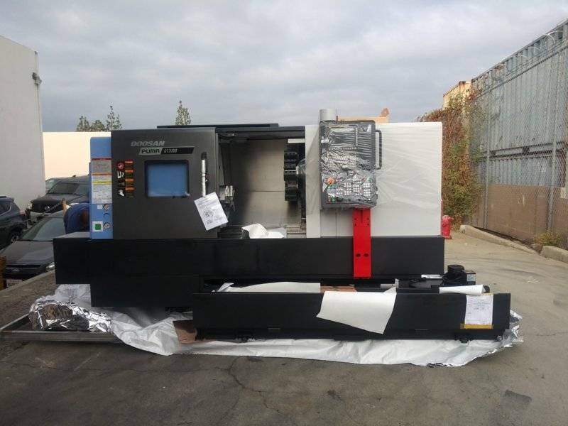

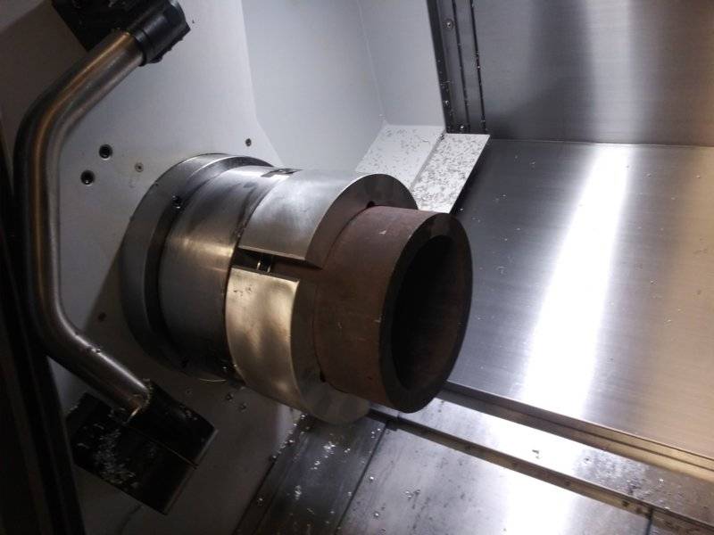

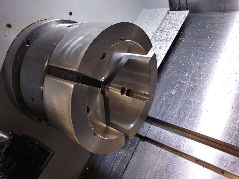

I'm a machinist.....35 years
We got a huge contract to make parts for bunker buster bombs.....
This part is 10" OD..... We had to buy a new, bigger lathe...$500,000!
The lathe will pay for itself in 7 months.....
Fun part to make....at least the first few...then I hand it off to operators.

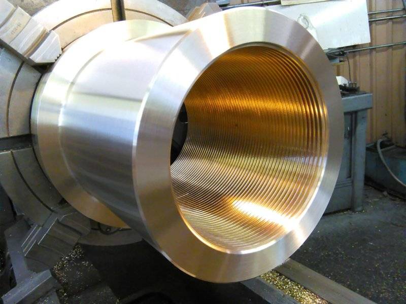

I'm a machinist/ punch press tool and die setter . you definitely have to have patience and focus. it can be trying at times. these are table stops / adjusting nuts for the 300 ton Pacific. these start life as 400 lb solid chunks of bronze that are meticulously machined on a leblonde 4 jaw and finish at 9.750 OD. they are ID threaded. raw material price alone is approx 6k .you absolutely cannot **** one up.

That's just flat out COOL!!!

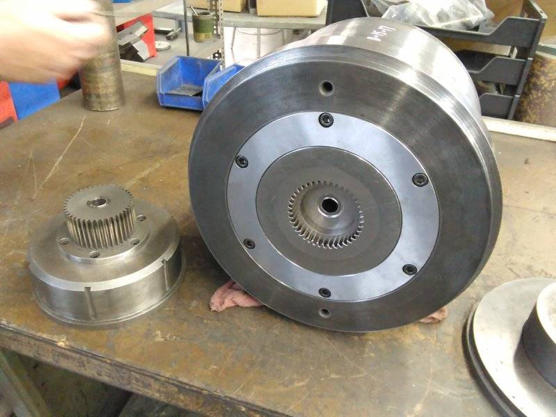

here is a die, die pot / bottom punch and top punch for the same 300 ton . this thing is a monster and weighs in around 250 lbs. the part is a gear roller for the automatic steps that pop out when you open the doors on certain pick up trucks.
the parts are compacted powdered metal, then sintered at 2,300 degrees , sized ,machined and then shipped.

that is totally badass and state of the art. we are still working with 30 year old lathes that work, but are still completely mechanical

Can't buy hollow material? Would save time if that's possible. Cut a lot of brass and bronze in my 26 years at the refinery along with 17-4, 316 SS, 11-13 Chrome (hated that crap lol), Cast Iran, and the list goes on. For the big stuff, we usually got material that was hollow. Lots of fun having to make a 14" OD pump wear ring that needed a 12" ID from 11-13.....not! Especially on a manual machine. There were a few times when hollow stock wasn't available and it happened more times than I cared for.
you would think they would order it already hollow. my understanding is that it's more cost effective for us to do the ID machining in house. i asked the same question a number of years ago. 2 of our machines use 1 pair each. they are usually replaced once every 3 years unless there is some kind of detrimental malfunction. I've been in the building when there has been one. the 300 ton over ejected which in turn ripped the die pot completely out of the table and split both the adjusters in half. it sounded like machine gun fire from the bolts ripping out followed by the sound of a bomb going off. it literally shook the building
