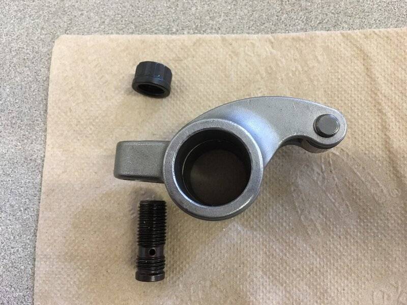

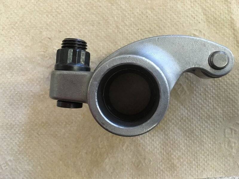

Just got these rockers for my 540 cu. in .557 lift cam. I got the adj pushrods and soft valve springs from comp. Just spent all day trying to get the correct pushrod length with no luck. Can someone help with a sure fire way of doing this task? I look on you tube for help and all you see is bowtie instructions that say this applies to all v-8's.

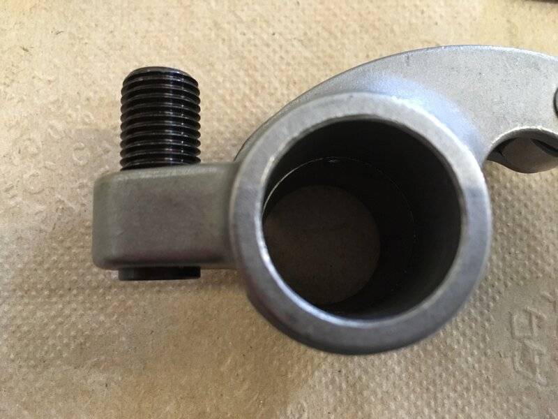

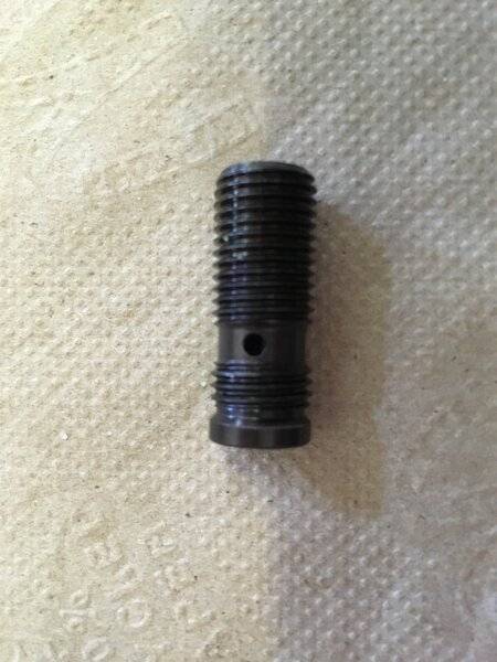

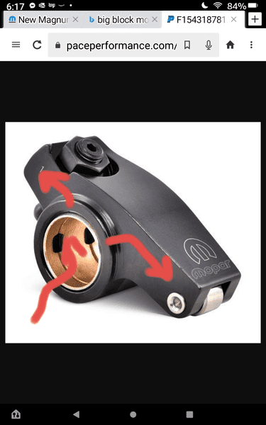

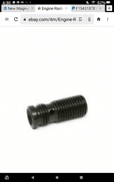

Attached is a pic of a rocker that shows where the oil flows. Also attached is a pic of the adjuster so you can see how the oil flows through it for the push rod.
Others may have a different process, and I'm not a pro either!

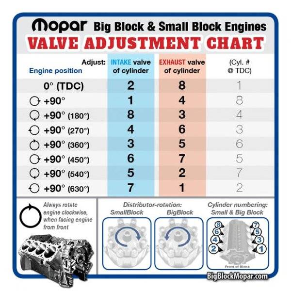

BBM-Mopar-Valve-Lash-Adjustment-Chart-607x607.jpg Screenshot_20210822-061747_kindlephoto-2076073909.png Screenshot_20210822-063004.png
Ok, let's back up.
FIRST - forget the above chart, you're not there yet.

to clarify this, you have a "cup" style adjuster. Screw it in from the bottom as far as it will go then back out one full turn.

These instructions are only for shaft mounted rockers with cup style adjusters, that oil through the adjuster, that cannot be screwed “through” the rocker arm....... all of this is applicable to the Comp 1621-16.
**The old “number of threads showing under the rocker” technique does not apply to these rockers**
There is an oil band on the adjuster screw that must line up with the oil feed hole in the rocker body.
The range of adjustment for that to happen is a nominal zero turns out.......to......two turns out.
One turn from seated is the mid point.
On these rockers, the adjuster screw is installed from the bottom:
Screw it in all the way till it stops:
Screw it back down one full turn, install lock nut, snug it down:
Install rocker on shaft, snug shaft down on head.
With cam on base circle(lifter as low as it can go), and checking pushrod in place...... adjust the length of pushrod/tool to eliminate all slack in the valvetrain.
If it’s a solid cam, have the correct thickness feeler gauge between the roller and the valve tip(the same thickness as what you use to set the valve lash).
**if you don’t use the checking spring, when the checking tool reaches the correct length, it will be hard to extend it any farther.
With checking springs, extending it too far will just start to open the valve.
I prefer to use the regular spring for the more positive feel when you’ve eliminated all the slack**
Remove the rocker from head, remove checking tool(being careful not to upset the adjusted length).
Measure tool. That’s the length of pushrods needed.
