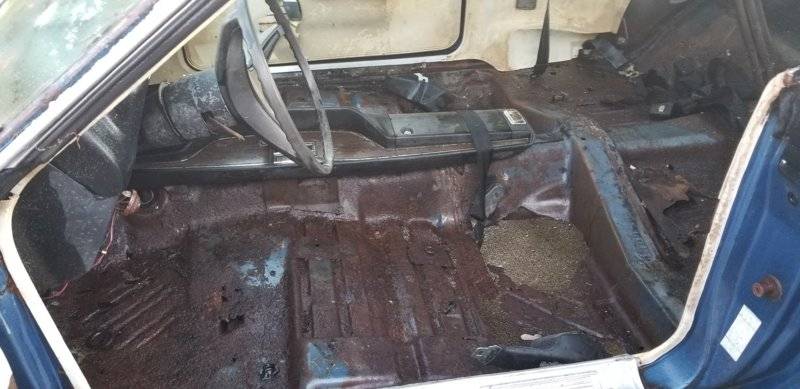

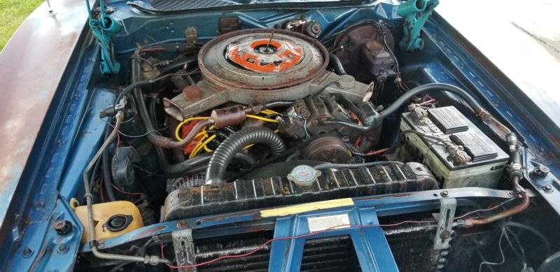

Hello. I'm wondering what the general consensus is on saving this 1971 Charger R/T. It has its born with U code 440 and 727. It's a B7 blue car with a white vinyl top (used to) and white interior.
It's also a factory A/C and hideaway headlights.

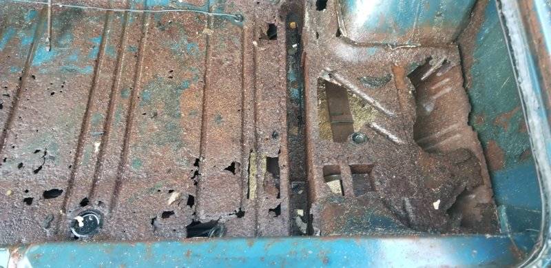

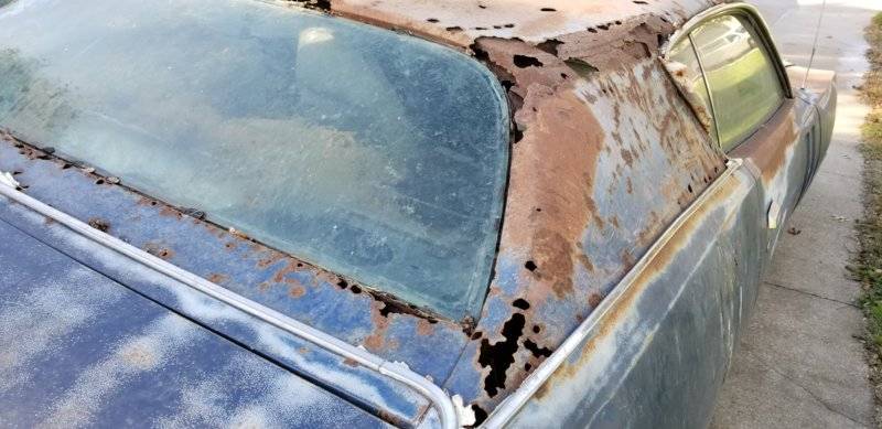

The roof is very bad and the floors are too. The frame rails look solid but I know that can go south. All of the R/T specific parts are there. The doors are amazing and the hood isn't rotted out. The rockers look good and so does the whole front clip.
I can do metal fab and body work fine and the project doesn't scare me. My question is how much is too much when it comes to metal work and replacement of sheetmetal?
complete donor roof is half the battle....better yet, a complete roof/rear clip..... those rear rails are questionable imo...... ....... I like the car
That roof is scary. I would expect that if the roof skin is that bad, the inner structure is just as bad.
Wow pretty bad rust. Think deeply about it. Some cars have been left to be used for parts. Welcome to FBBO from SoCal
There is alot more work there than meets the eye. But if you can do it, keep it all aligned, etc, then do it. Save it! You'll have plenty of support here.
welcome to FBBO save it i like it will be a nice car when its done
Thanks for the welcomes and replies. It's not going anywhere for the time being. I have found a roof complete with the inner structure. It will definitely be a time consuming project.

Welcome from Michigan. I think this can be saved. Especially being a 71 R/T. Got some major cutting and welding to do. I agree with the above as far as the inner structure goes. Make sure you are satisfied that the structure pieces are good. Good luck and create:thumbsup: a build thread if you save it.
