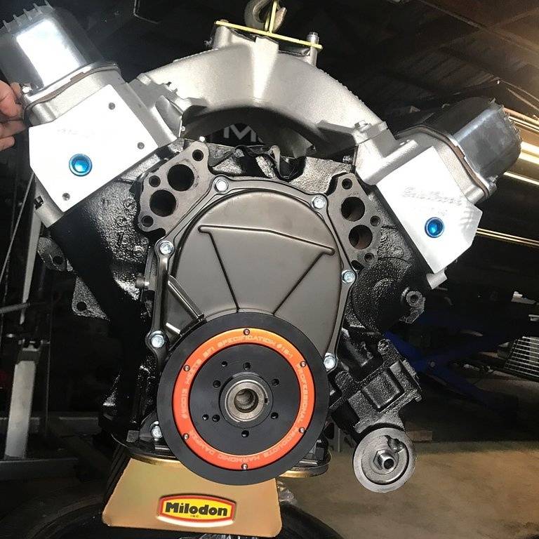

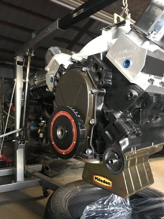

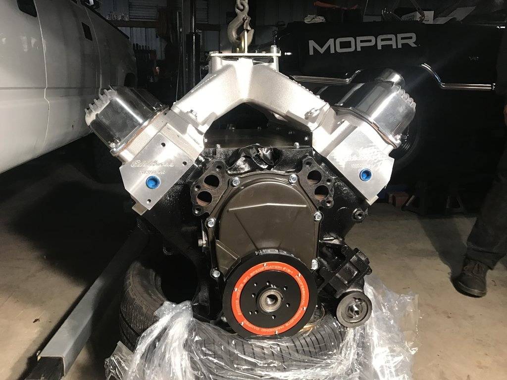

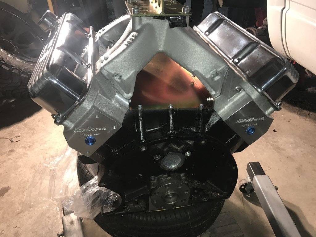

Hey guys just got my 505" back the other day, waiting on water pump and pulleys to be delivered still but got a couple pics I thought I'd share
Eagle 505 crank and rods
Max wedge victor heads
Super victor intake
Comp RX296R-8
263/270 @ .050
.650/.651
T&D 1.6 ratio rockers
Ferrea valves
TTI 2"-3.5" headers
fitech 1200
