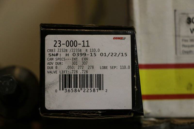

My 400/500 stroker, Ported MW Victors, 272/278@ 0.050", 0.720" lift. I put the FiTech 1200 PA on the engine because I had it for another project and it works well, but I think the smaller 4150 (800+? CFM) may be limiting peak power. On the other hand, very streetable and great throttle response.

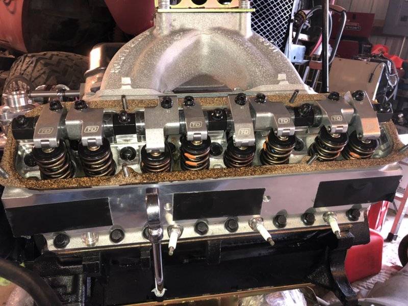

Then milled off rocker stands, installed 3/4" deep Time-Sert stainless inserts and used Aluminum MW style Rocker stands with ARP hold down bolts. These too were milled to set rocker geometry height.

To get 2" valve spring height for PAC-1326 valve springs, used PAC valve spring seats that were milled to 0.030" thick vs the standard 0.060" thick, and used higher install height retainers. I think from PAC also, but not sure of the part number?
I used the T&D 1.6:1 ratio rockers arms with 0.725" offset intake. They now have paired shaft rockers that look like a better option?
The cam is a Custom Comp HXL lobe profile:
