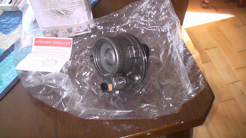

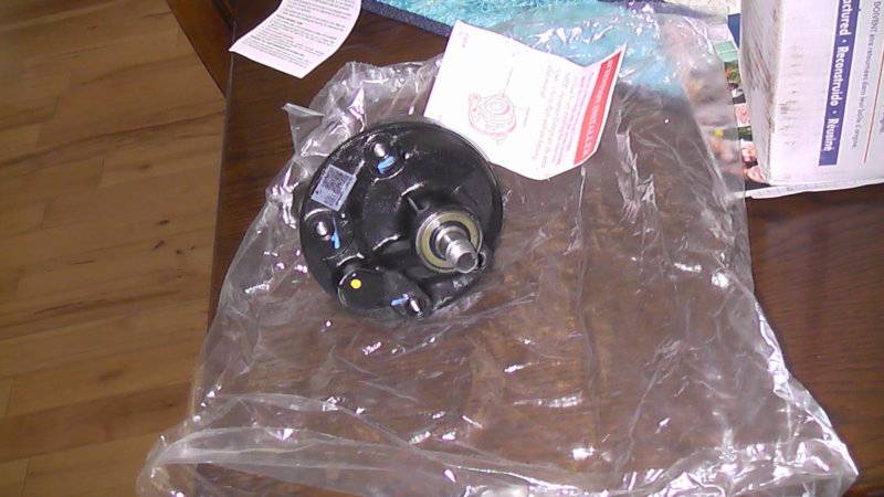

Just got my ps pump for the 71 satellite,i thought it came with the reservoir,the 1 on the car looks like its all 1 piece.at rock auto it has the reservoir,did it get the wrong 1 .what gets me is how the reservoir is sealed the the pump housing.

That's a pump you need to use your old reservoir. Make sure you got the right one they used two different pumps in that year
Also it's a fairly easy job the pully is a pain auto zone rents a puller if you don't have one
OK i research it,but i think i will take it to someone who has done it before,i don't want any leaks.thanks for the help.

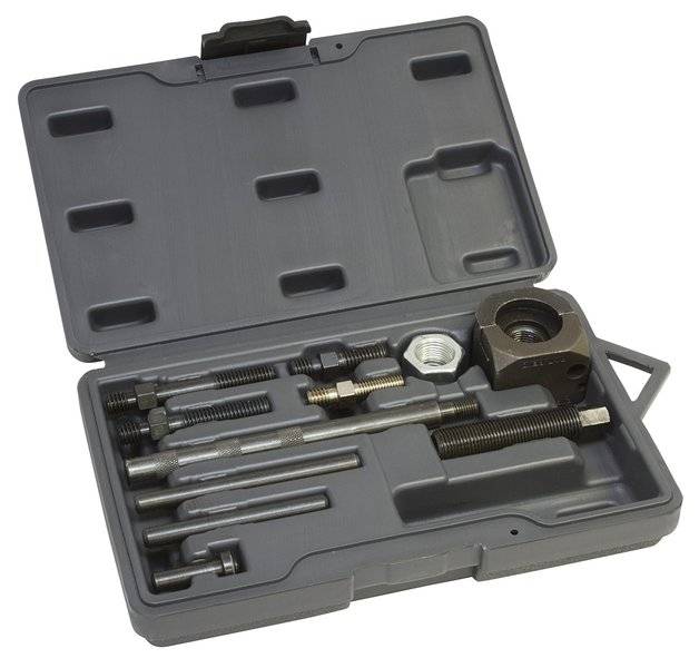

The same puller that removes the pulley is also used to install the pulley - no pressing required or recommended less you want to bitch the bearings.
Can you provide a photo of the puller/installer please?
View attachment 611197 View attachment 611198
Make sure you get the pump tight to the reservoir or it'll leak like a sieve. Plus you need to make sure the pump and reservoir are clocked right so it bolts back in like the old one. Take pictures for reference before you disassemble the old one.
Is your pump shaft, sounds porno, threaded and have a keyway?
i have threaded and keyway. also glad that someone else gets the great help on this topic.I learned a lot but still i bowed out and sent it out to be fix.call me yeller.lol i cant stand leaks.
Saginaw pumps don't have a pressed on pulley. Federals do. Sags have a nut and keyway.
Which pump do you have? Beings it a 71 its probably a Saginaw.
Saginaw does have press fit models. Chrysler switched to press-on around '73. Since he ordered the guts, and others were discussing pullers, I did assume he received a press-on unit. Now we all know he just needs to remove the nut and key and switch it out.
