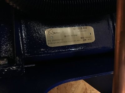

Finally...

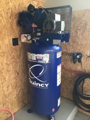

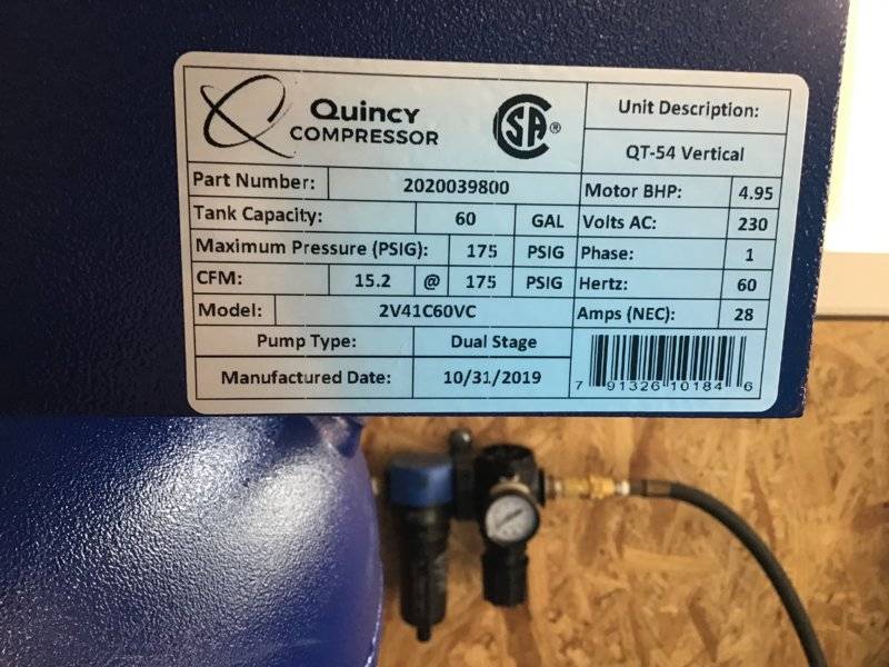

New Quincy QT-54 Air Compressor 2V41C60VC
2706280B-2F63-4392-8BA4-0919B38908EB.jpeg E7B16D28-12BB-4347-9BAC-33E2CA6DEACD.jpeg D3E5C521-D7C7-4D5D-8917-EEBA1D1EE51C.jpeg 9CD1D7EE-D606-409F-A8C7-C24DA2C89056.jpeg 1829F603-A191-4B21-B5C6-5465AF2934C7.jpeg CE8FDDF8-F4B2-465A-8EA5-C821B8CEDBB5.jpeg 77EEFF78-CED4-47B6-B7ED-F1171A0A3AF3.jpeg

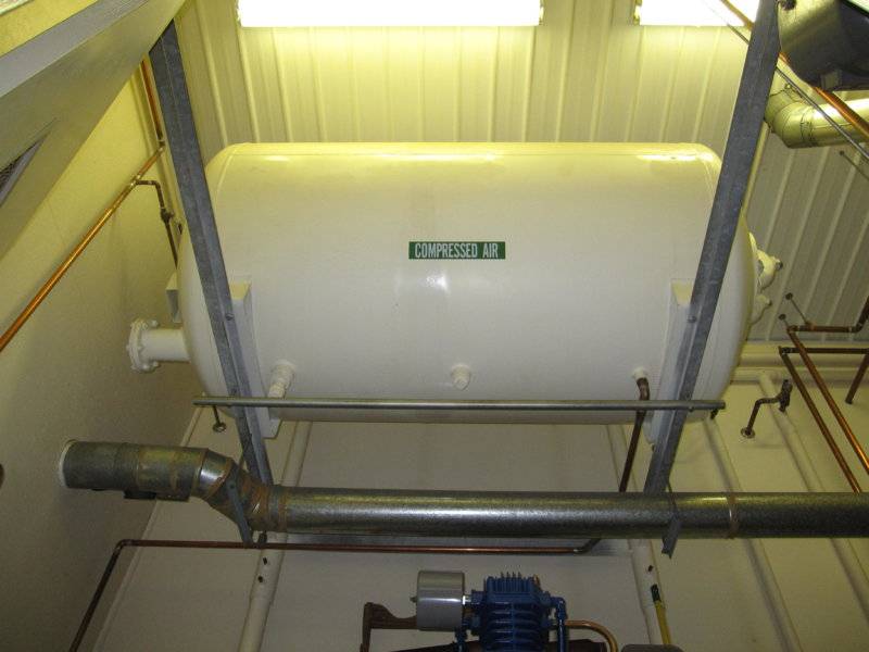

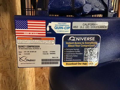

Well you showed me yours so here's mine: notice my 500 gallon "extra" tank.
Mike
Funny how an electric air compressor has to have a California compliance sticker on it.
I do like the compressor!!

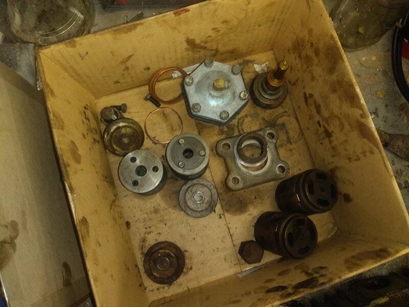

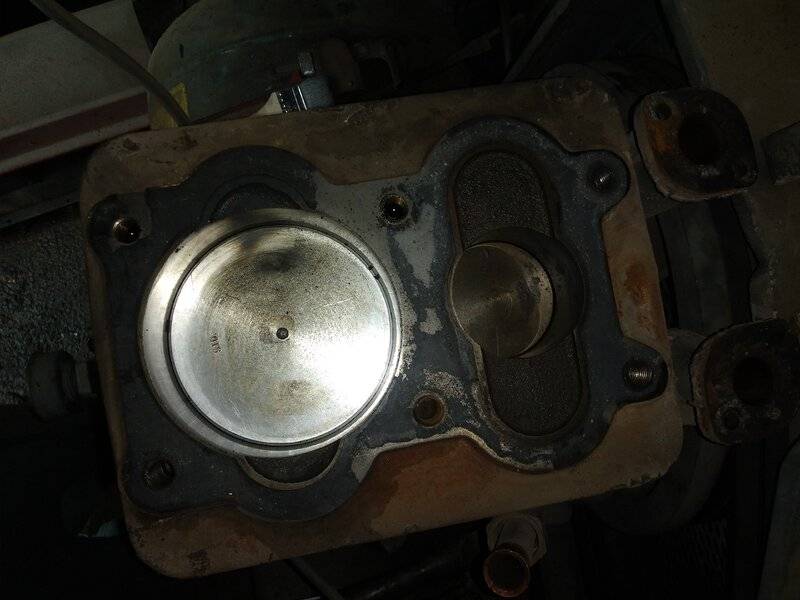

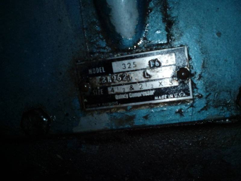

I learned alot about these Quincey 325's this week....... they been making them for ever, and not much changes......... I was always told these were bullet proof. I found out they are built to pretty much to run non stop for ever, lol

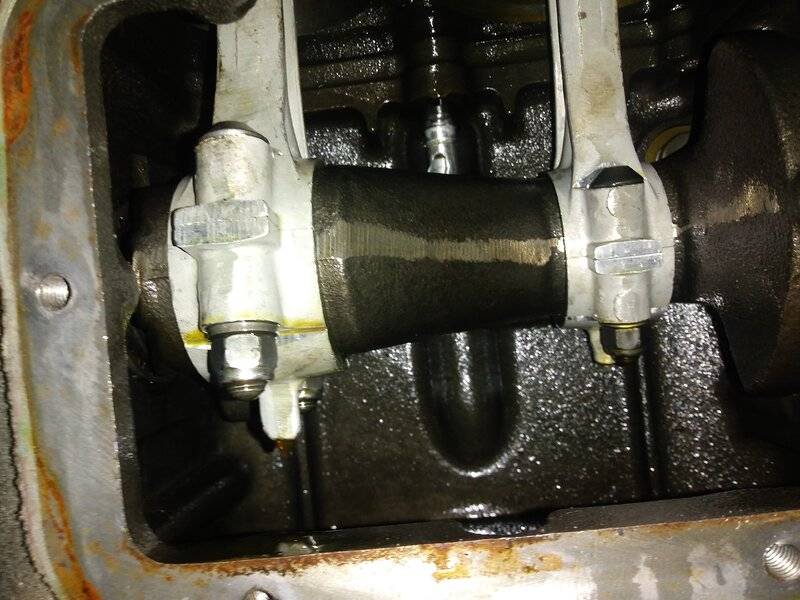

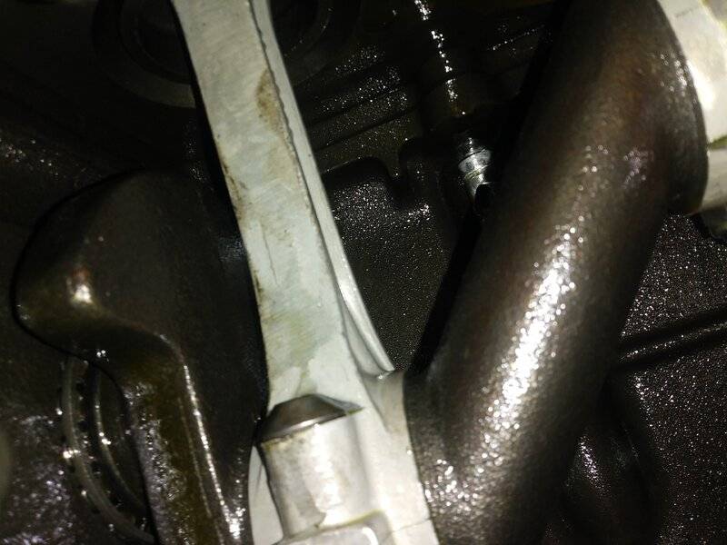

anyway, I noticed my 325 getting noisy, but oil pressure was always good and it always pumped good air; but just last week it started knocking, like a rod or a wrist pin. So I open up the side cover, which has never been opened....... and it is freaking spotless! I give it an oil change every now and then but not often enough. anyway, it's tight as balls......awesome

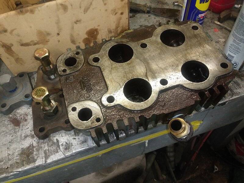

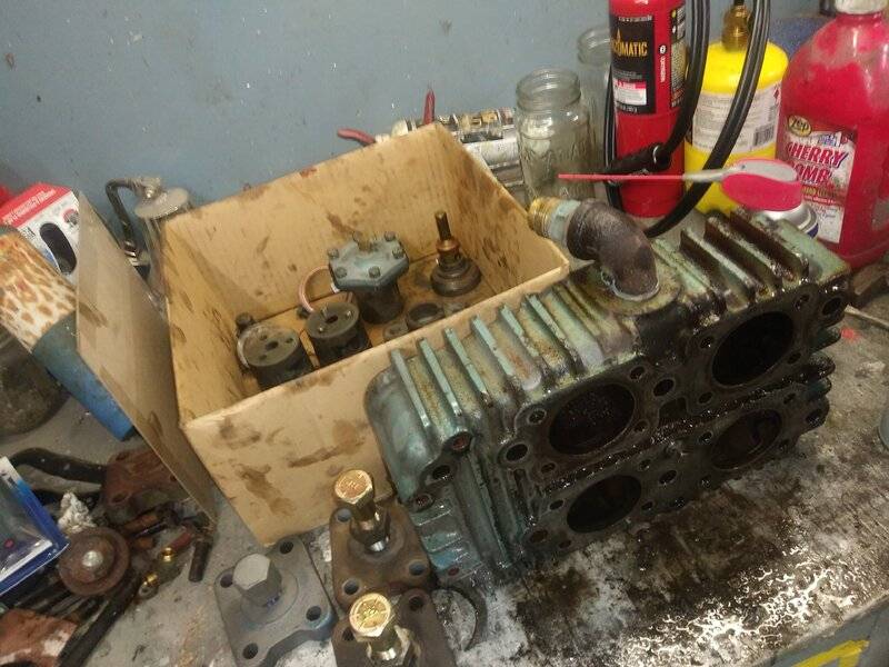

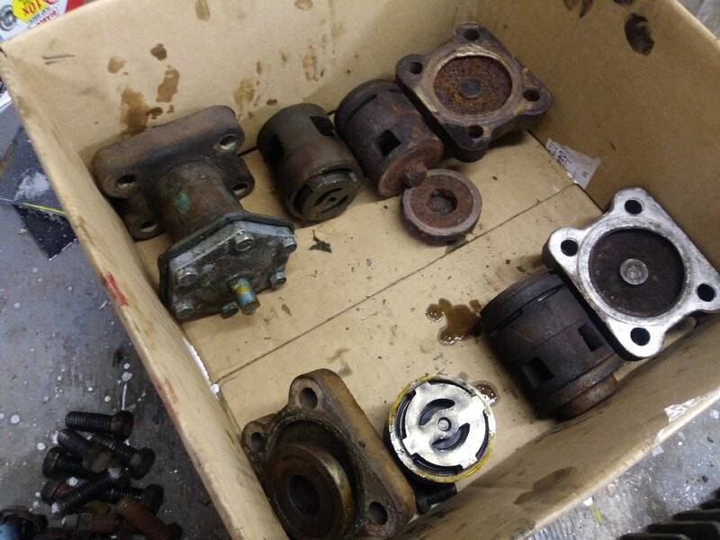

so I start opening up the top end, everything clean except the top of the high pressure discharge valve assembly...... lol, I became an expert this week.
there are no moving parts! I didn't expect that
the valves are just sorta like flat washers sitting on a spring. they move according to suction and pressure who knew?
I never really gave it any thought, never had to....... the thing just runs

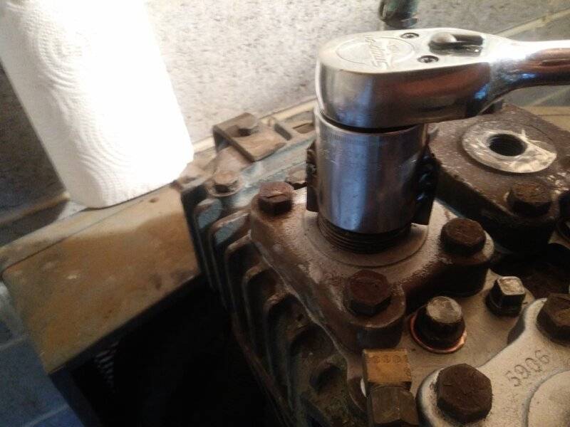

anyway the valve assembly gets held down tight into the head with a jamb bolt and a lock nut, there is a copper washer at the bottom where it seats into the head.
evidently, the high pressure discharge valve assembly at the top is a point of condensation and gets rusty.... probably from not running enough, long enough, to get hot enough; imo
turns out my hold down lost enough material to loosen up the valve assembly...... that was my knock
hardest part was extracting the all the hold downs...... 2 of them broke off, even with heat. I made my own

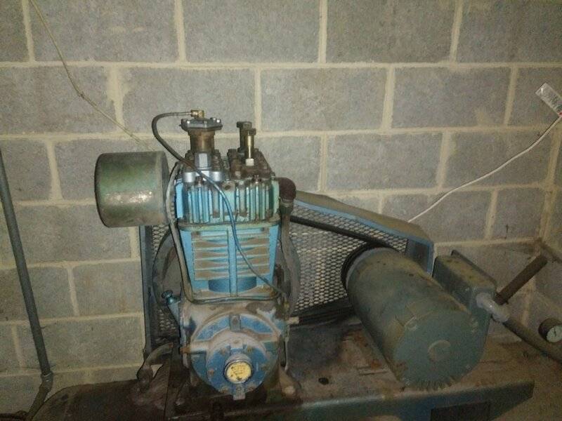

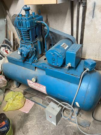

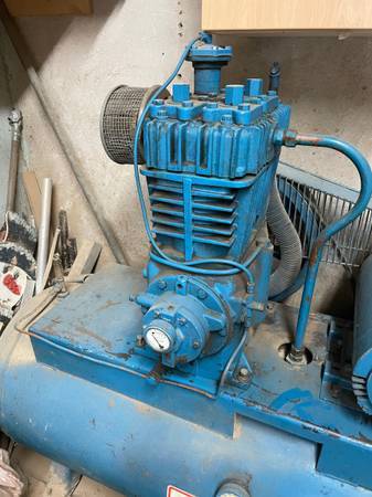

Mine does live in my mechanical room with the boiler which I also use for domestic hot water so the room is always warm and dry. I hope yours will continue to serve you for the rest of your life!
Mike
I even made my own quincy unloader tool..........
anyway, she's all tightened up and quiet as a church mouse! just a suckin and a blowin :hitit:
it hasn't moved from that spot since 1997, I need to bring her out in the light and give her a power wash...... maybe next week :rolleyes:
