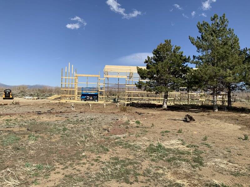

New shop build out coming to life
Trusses showed up today
I’m hoping, without spending more money on a steel building or stick build they were closest ones around here. And to even get anyone to come out has really been hard.

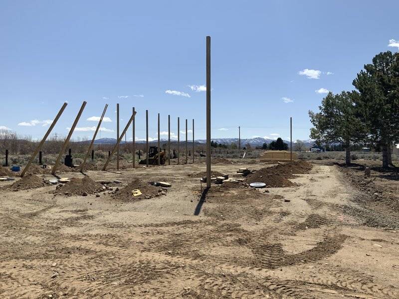

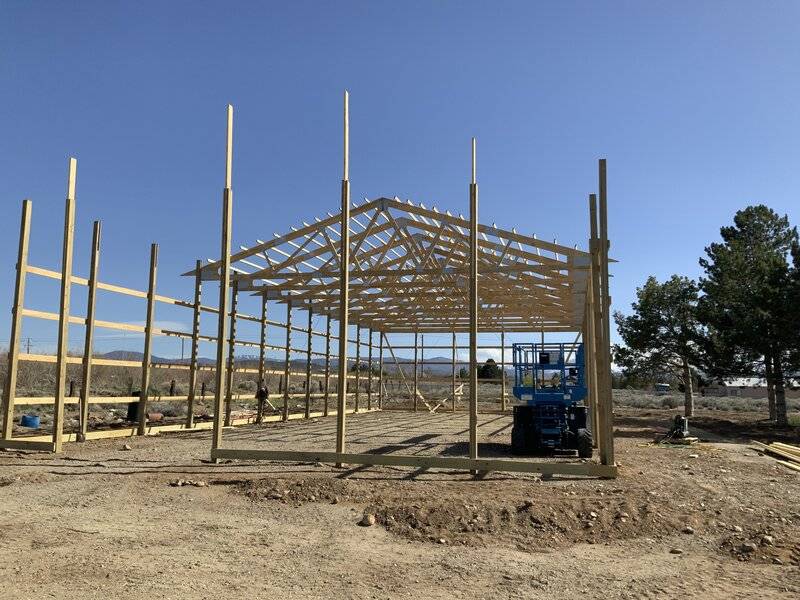

Should have gone bigger that’s what happens when u ask the other half. So poles are up trusses next week.

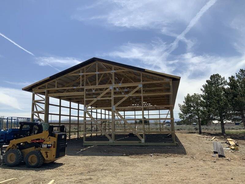

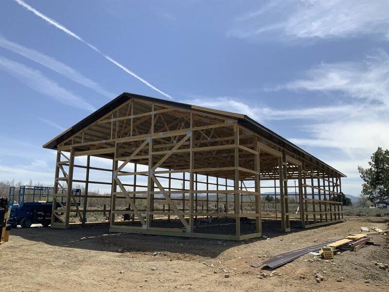

So 3 more trusses to install moving little slow due to weather but its moving. Garage doors probably to big but its done now should have made the 2 little shorter.
6” slab number 4 rebar every 24” 4000psi still working out epoxy paint for floor, interior details many ideas though
