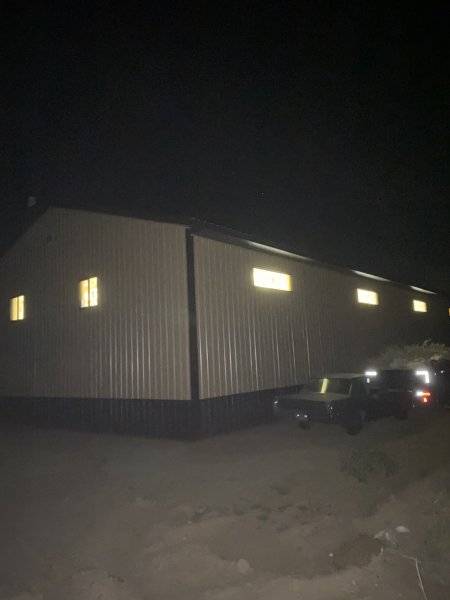

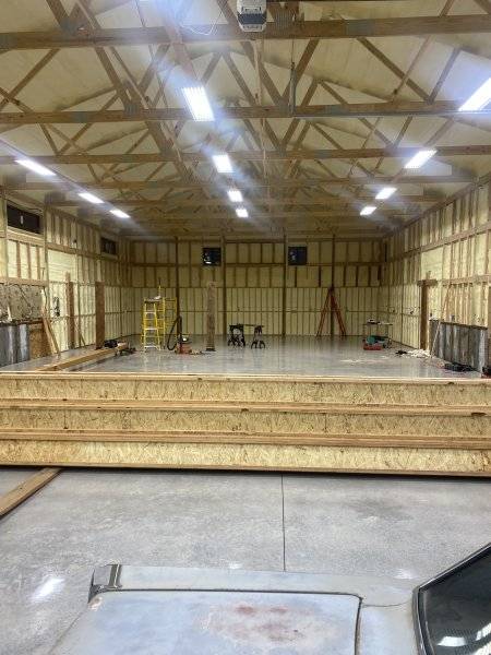

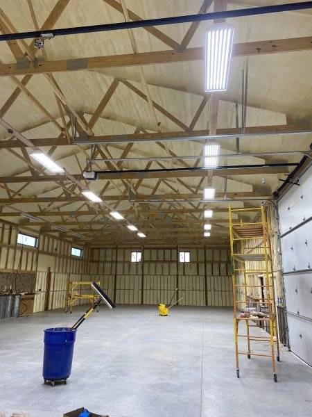

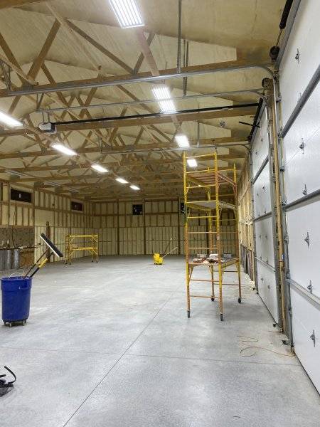

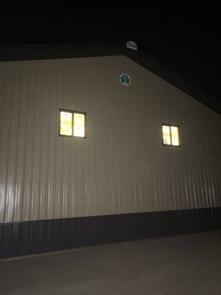

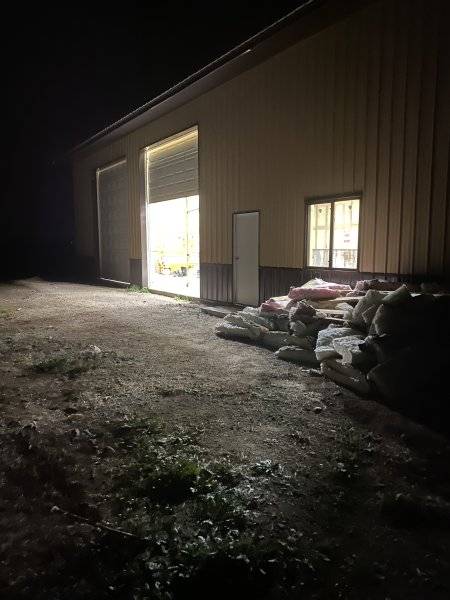

Got power , had a bad breaker but 2 rows of lights working. Did not go all the way to the back with the lights because will be building a mezzanine. Plenty to still do build paint booth, build mezzanine, air compressor going under stairs, ram wire for exterior lights, patio area out front. I wanted it really bright so far so good.
Got power , had a bad breaker but 2 rows of lights working. Did not go all the way to the back with the lights because will be building a mezzanine. Plenty to still do build paint booth, build mezzanine, air compressor going under stairs, ram wire for exterior lights, patio area out front. I wanted it really bright so far so good. View attachment 1359361View attachment 1359363View attachment 1359364View attachment 1359365View attachment 1359366View attachment 1359367
I love my LED lights. I'm a little further along than you are. It takes time and it's frustrating, but you'll get there.
Great job, as a 'bulbhead' for fifty years, there is no such thing as too much light available . I began converting family and friends over to LEDs years ago....awesome.

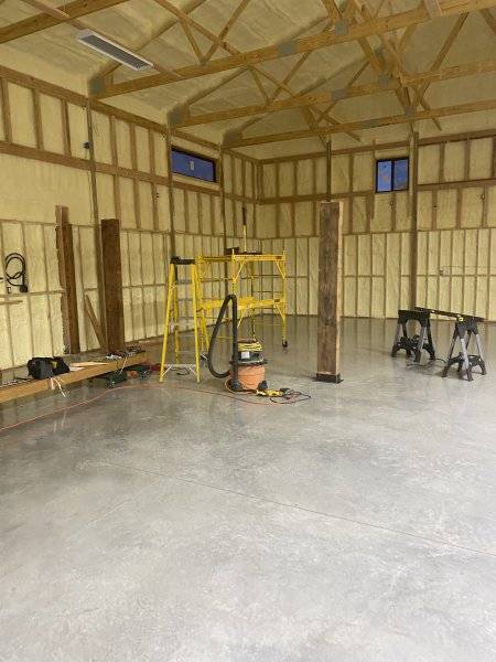

Sealed my floors with Ballistix sealer, they look great let’s see how the hold up. Next on time building out the Mezzanine . Before and after picks
Received my I joist (44) qty and 1 12x42 header ready to build my mezzanine. Made my feet bracket out of 1/4 steel and header bracket. Paint booth will be on left side 16’x 26’ and open on R side for tool boxes and around perimeter and full bathroom with shower far right. Waiting for my forks for my tractor to lift the header into place.
Im still considering going up through the roof, or up out the side of shop. Theres a vented window i may pull out an have ducting going up out booth. I want it all so work correctly and no make shift so there still little bit of research to do still.
