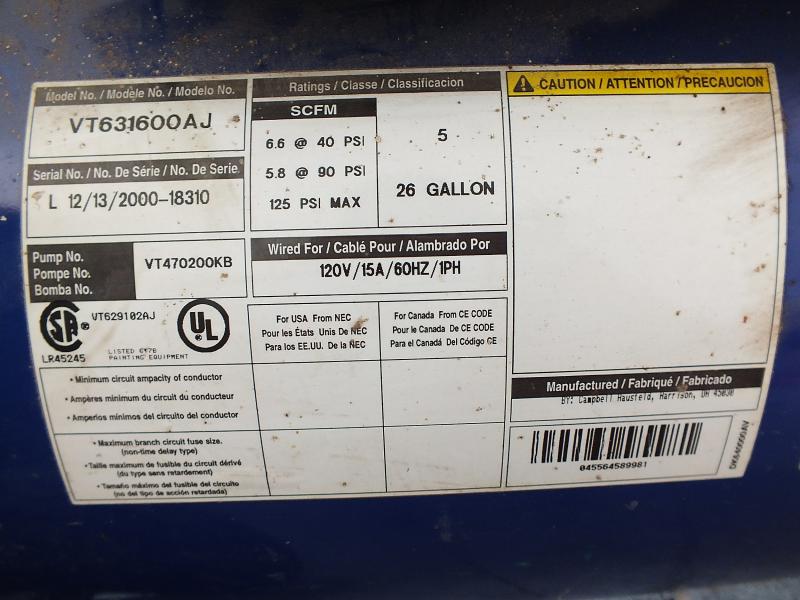

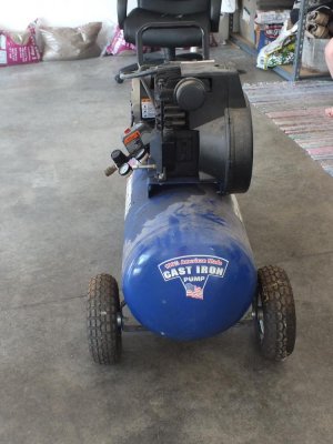

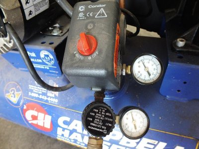

I brought this home this weekend. 13 years old according to info on sticker but only used for a year or so by my brother before he passed, then sat for at least the last 7 years w/o use in an unheated and uncooled garage in Southern IL heat and cold cycles. We have very high humidity :)
I plugged it in and since it was in the "auto" position it started right up and before it occurred to me I shouldn't run it w/o changing the oil it was on and running. It ran perfecting for about ~ 30 - 60 seconds and built up 20 PSI quickly then I shut it off. It maintained that pressure for a few hours w/o losing pressure / gauge moving then I bled the pressure off and went to open the stop or drain cock and it wouldn't budge. (it may actually already be open ? )
I have no prior experience with maintaining Air compressors
Oil is 10 years old at least
What is best brand / type of compressor oil or other for a unit like this?
The drain cock appears to be stuck and if I force it i'm sure the "handle" or whatever will break loose. I'm going to shoot it with some PB blaster if that's not a bad idea.
I checked out some vids on removing the drain cock and replacing with an elbow, 4-6" of pipe, and ball valve to ease draining moisture. I've been reading that its best to drain the moisture every day (assume only when it's used ? ).
Should I leave the drain open when not in use or just open and drain when I've run it?
I have a NAPA like 1/2 a mile away and AC stuff is expensive but they are well stocked and I have access to some 10 plus-plus year old AC tools that I'll pick up in the next couple weeks.
I've got two, sections of hose, I think ~25 feet, but they are old as the compressor so I don't know if they are any good. The garage is a modern (small) two car.
I will not be painting cars but possibly could wind up using it to paint parts in future. I will be using impact guns, probably getting a small garage type blasting cabinet for small parts, possibly cut off wheel, grinder, etc mainly for mechanical work, probably not for serious body work.
I don't see running lines for air drops around the garage in my future.
Should i get some type of dryer, filter and or water separator system to add on?
Any and all advice and recommendations are welcome.

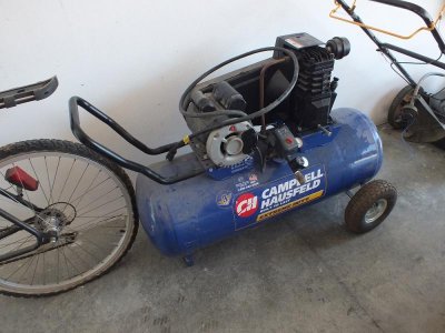

Here are some photos.
comparessor 26 gal max 5 HP extreme duty.jpgcomparessor 26 gal max 5 HP.jpgcomparessor cast iron pump.jpgcomparessor electric motor.jpgcomparessor gauges.jpgcomparessor gauges2.jpgcomparessor model and ratings.jpg

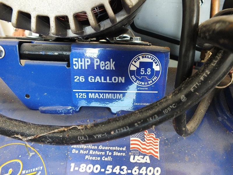

If the drain was open it would bleed down. As for oil, CH compressor oil should be fine. Vapor separator and oil sep would be wise, helps tools last. That thing will be running like crazy for a grinder or cutoff tool....oh, and a line regulator would be nice as well...congrats on a compressor, sorry to hear about brother...
Oh yeah, and keep the drain shut aside from draining it....no sense letting more moisture in..

I don't think you're gonna like the results of trying to use that 5.8 CFM comp for blasting.
I have an 8.4 CFM DeWalt/Emglo (not cheap) unit that can barely do a bracket, and I sure wouldn't want to do a battery tray with it.
Sand/media blasting is arguably the heaviest load anyone will ever place on a compressor.

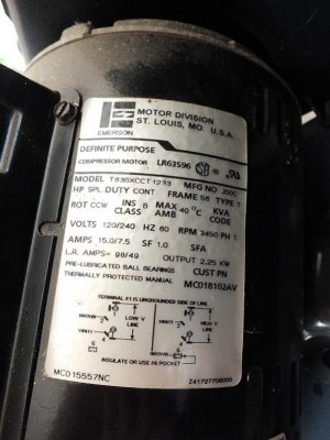

The best thing you can do is change that motor to 240 like it says on the data plate.
It has a 115-volt plug on it now (“wired for”) so that would have to be changed to do it right.
By going to 240 you will cut your current in half (7.5 amps instead of 15).
The motor will run stronger, cooler and last longer.
You will need a 240-volt line in your work area. If you can’t do that, I’d pay someone to do it. If you were close, I could even help you. I like 240 available where I am.

I'm pretty sure you don't just have to change the plugs. If you look at the schematic on the motor in the pics tallhair posted you can see 2 different configurations of the wiring in the motor. On the left side of the wiring diagram you can see how it is configured for "low v" which I have to assume they mean 120v. Here the brown is on terminal 2 and the white is on terminal 4. On the right side is the "high v" (240v) configuration with the white on terminal 2 and the brown on terminal 6. These terminals are usually located on the side of the motor under an access cover where the plug wire goes into the motor. I'm pretty sure if you just changed the plug and then plugged it into a 220 outlet, you would probably fry the motor. You have to swap the brown and white wires in the motor to the proper terminals to switch it from 120 to 240. Should take 5 minutes with a screwdriver and a pair of needlenose pliers.

Update to the sitchiation on the compressor .. I was able to get the drain cock loose and there was no water in the tank and I know it the drain works so Yay! I also checked the fluid and my uncle who's used to run his own repair shop looked at the oil and confirmed it was compressor oil (thought that my bro would have run compressor oil and it looked different) and looks brand new .. so we fired it up and it runs great and holds 125 PSI which is it's max rating. We used it to air up the tires on the RT when it came off the trailer which made it a lot easier to maneuver around in my little garage.

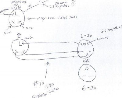

I think someone is exaggerating. 1500 sounds sort of high torun simple receptacle.
Doing it yourself would save you money. That’s the kind ofperson you probably are.
It gives satisfaction. And you learn.
The 6-20 is at that link I gave you. It's a plug type. Look in the yellow part. 20 Amp plug.
But I’d have to say exercise caution if you know nothingabout electricity and don’t tackle it with just this Internet advice for thehands on part. Maybe there is aneighbor or buddy close by that could help.
You can do this yourself for a few bucks and a trip to LowesDepot. Make a simple adapter extensioncord. I did it years ago when I needed 220 at a rental house garage and didn't want to put the money in the house. I’ve still got the 50 feet of SJ cord.
Your dryer plug may be a little different. Post a picture if it is. See how the 110 and 110 go to make 220?
Some will probably yell about this. But it will work andyou will be “mobile” with your compressor.
The CB is still protecting the house wiring.
Thanks for the diagram only one and like they say a picture is a worth a million words. I may give that a try as suggested up thread it should be better for the motor durability. So my understanding is .. just make the proper extension cord like the pic and plug it into the dryer receptacle with no mods to the electric motor on the compressor and run with it .. right or wrong ??
I'd just make sure the tank is drained, oil is full, and fire it up. It's a $75 compressor at most and chances are the reed valves are rusty as hell from sitting. No sense in spending any coin on a compressor like that before you know it works, IMO. Kind of akin to a "yard machine" lawn mower they are somewhat disposable. It's not big enough for much more than running some air tools, filling tires, and blowing stuff out. A compressor that size might even struggle on really tough bolts using a 1/2" drive impact.
On the wiring part just plug it in and let it rip. If it trips the breaker you either have something else pulling substantial amperage from that breaker or a weak breaker. Fluorescent lights don't really count unless you have a bunch of them. I think the dual bulb 8-ft. lights in my shop pull about .75A per ballast. Also, you may find that it takes more amperage to start the compressor during the cold weather months.

If fired right up and ran just as it's supposed to Jeremiah. I'm just really happy to have a compressor at all ! LOL and bolded above is more than I've had before so it's a major help and improvement for the a hem "Shop" LOL
DO NOT USE DETERGEANT MOTOR OIL IN A COMPRESSOR! Car motor oils have detergeant agents in them to capture any dirt/particles in them to be filtered out by the car's oil filer. Air compressors DO NOT have an oil filter. Need to use compressor oil so the particles fall to the bottom and are not trapped and circulated in the oil.
Yep I'll probably stick with the compressor oil and get some more soon to change it out and then continue to do so on a regular basis like once of year or so
