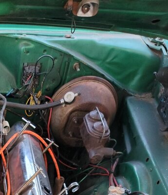

I've got a '68 Plymouth Satellite 2dr.
I replaced front shoes and springs, and I should probably get around to doing the wheel cylinders. Those have not been done yet. I also have not bled the system. Still trying to figure that one out. Never bled a brake system before.
When the car is off, pedal is hard.
When car is running, pedal is soft, all the way to the floor. With basically no stopping power, the brake light on the cluster comes on before I can get stopped. I'm pretty sure I have power brakes, well at least, I'm supposed to.
Where do I start with working through this?
Thanks!!

Hey PurpleBeeper,
So, I followed your instructions and the only wheel that had brake fluid flow out was the passenger front wheel. The other 3 had no fluid that came out. I'm thinking probably collapsed rubber lines or blockage in the metal lines? At this point, I'm thinking I should replace the wheel cylinders, rubber tubes, fittings, etc., and then bleed again?
I did attempt to bleed with the lid of master cylinder off, and the fluid did shoot out of the front reservoir whenever I let off the brake. Saw negligible, if any, movement on the rear reservoir. Removed the fittings from the master cylinder and when the brake is pressed, fluid does come out of both openings, but it does shoot quite aggressively out of the front reservoir anytime the brake is pressed.
Let me know if there is anything else I can provide to help troubleshooting.
